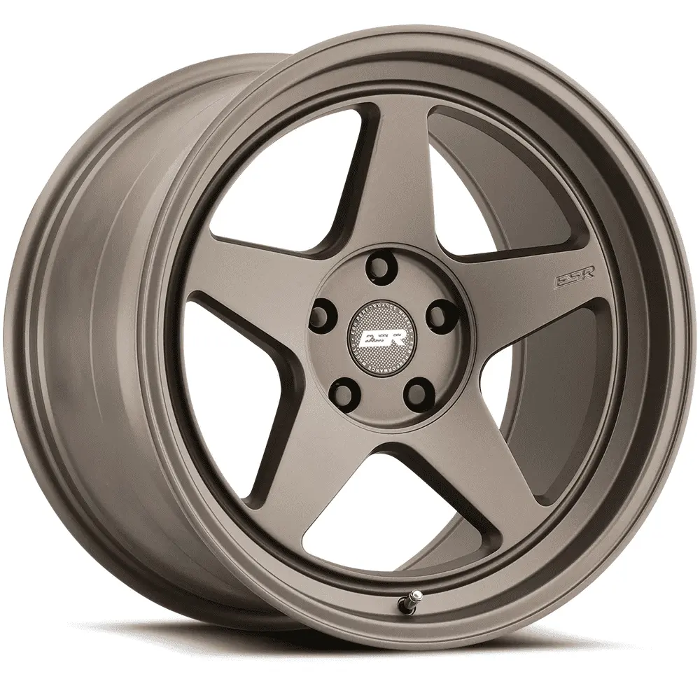

I am far from a wheel/fitment/stance professional...
Contemplating 19x9's with either +32 or +20 offset and 245/50 19 tires to maintain the rolling diameter for AWD, and ability to use the spare.
A quick photoshop:
In the past I used spacers with proper extended lugs to perfect the offset. But with lug nuts I don't want to mess with spacers.
I feel like +20 is a bit extreme, but the online calculators show that it lines up with the stock inner wheel. Only issue is that it pushes out the scrub radius a bit, and possible fender clearance if/when lowered.
I feel like there is more to the equation as well...
- Hub centric rings as the CX5 is 67.1 and these wheels are 72.6
- Should I be considering lug stud diameter as well?
- Lug nuts (I know that there are different versions to be aware of)
- TPMS sensors?

Are you trying to get the perfect stance for looks or functionality? Because 20 offset with what you wrote out is going to poke a ton… not functional what so ever

245/65/17
17x8 et38
Sits like this for reference. Obviously much more aggressive tire but for reference. 19x9 with et 20 🙈
Offset:38
Tire Size:255/45/R20
Another 18 out.. and wider wheel…..
not sure what you are shooting for.

My thinking... People are running 25mm spacers with the stock wheels (45 offset), which leaves it at 20mm and it looks great. But, come to think of it, that's with a 7" wide wheel. Another 2" would be a bit extreme. Back to the drawing board.
