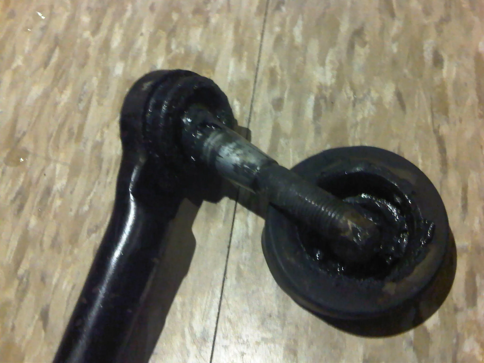

If you can take it apart without damaging the boot of the outer tie rod, check how stiff/loose the stud is. If its stiff, the outer one is fine. If you live in the rust belt, chances are you will have a nightmare trying to remove those tie rods from the knuckle and the inner rod, especially if you try doing so without damaging anything.
Here is a worn out outer tie rod end that I took out of another car. You can see how the stud doesn't even hold against gravity:
You're supposed to measure the gravity,...
I was only showing an example of what a worn out outer tie rod end looks like, no need to test anything when you see the tie rod end is that bad...
Ideally, you are correct about getting scale measurements. However, how often does someone easily remove their tie rod end to measure something like this? From experience, people change them because they know or suspect that its a problem area, and most of the time by the time you get the darn stud out the knuckle, the boot is completely torn, in which case it needs to be replaced.
