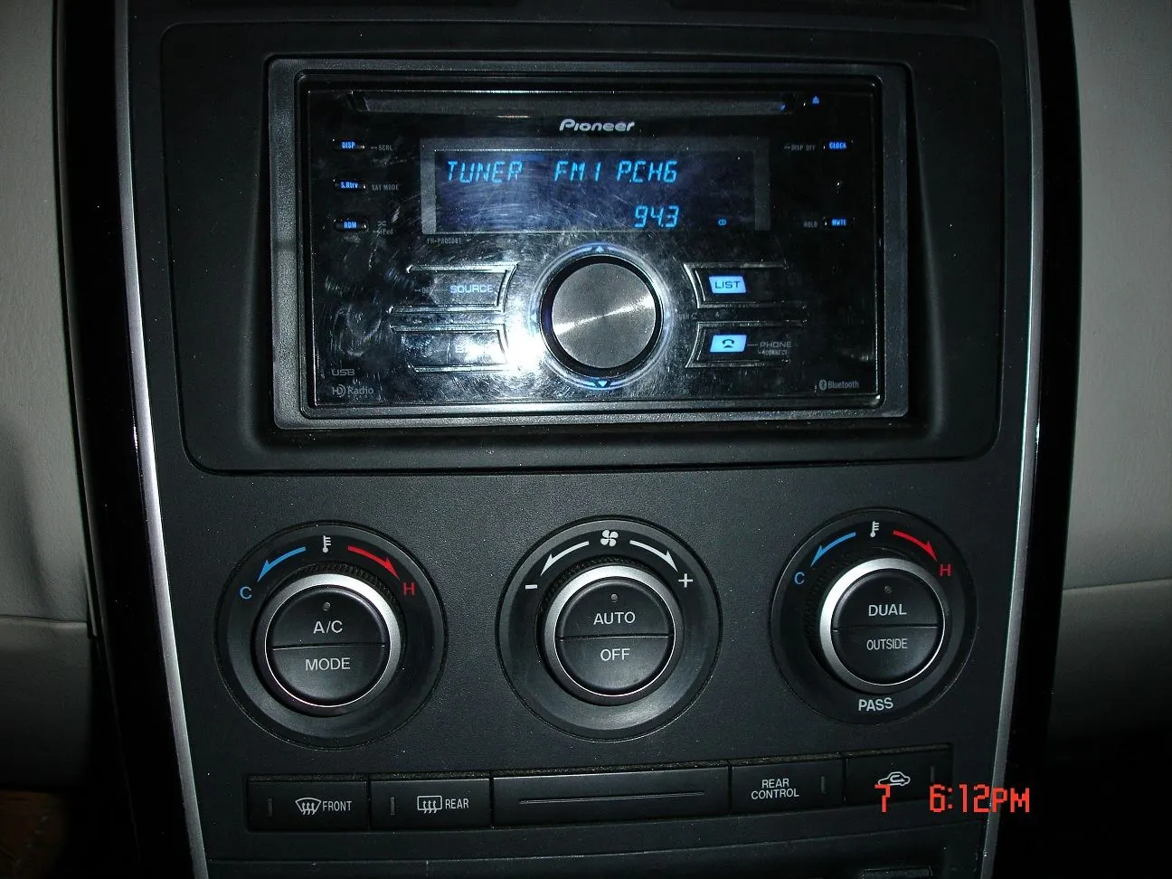

I have a 2007 Mazda CX-9 Sport. I installed a Pioneer FHP-8000BT duel-din stereo in place of the Mazda factory stereo that had Sirius satellite without Bose Audio, I also installed and programmed the PAC SWI-PS for steering wheel controls. Everything works fine except now I have no lights around my 3 heating/Air conditioning knobs at the bottom of the console. I checked the fuses behind the glove box and didn't find any blown fuses. I did notice that there were 2 illumination wires on my 70-7093T. If anyone has any ideas or has come across this I could really use your help. My young daughter drives this at night and I am worried for her safety because she has to turn on the overhead light to see where the heat/ac controls are. Thank you. Jamie Lessard
