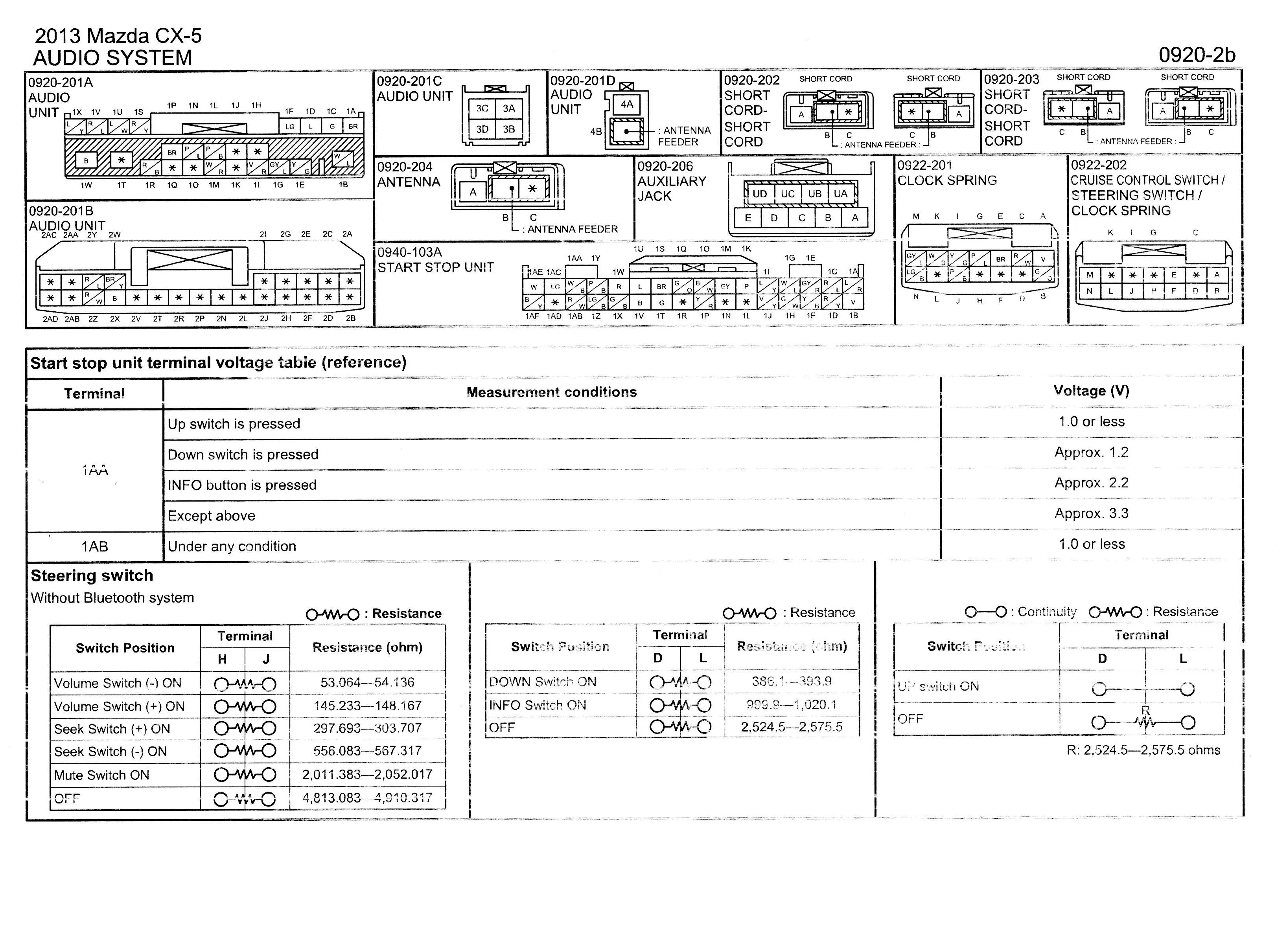

When you tapped in using the Line Out Ocnverter, did the facotry wiring follow the purple, green, gray and white wiring standard most aftermarket radios follow for Left Front, Right Front, Left Rear, Right Rear?

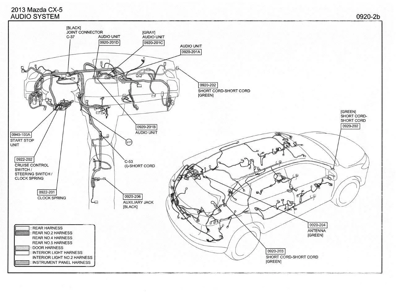

Also, if anyone is interested, Metra has some stuff for the CX5. (http://www.metraonline.com) They show a factory wiring harness for 01 and up Mazdas. http://www.metraonline.com/part/Mazda_wire+harness_71-7903 This harness matches the AUDIO UNIT 0920-201A connector in the audio system wiring diagrams I got from the dealer. (attached)

To be honest now I do not remember even looking at the colors. I just looked at the pin outs and tested my guess by cutting the wire and that speaker went out. Sorry I cannot be more help. Take your unit out if you have 5 minutes and have a look.
