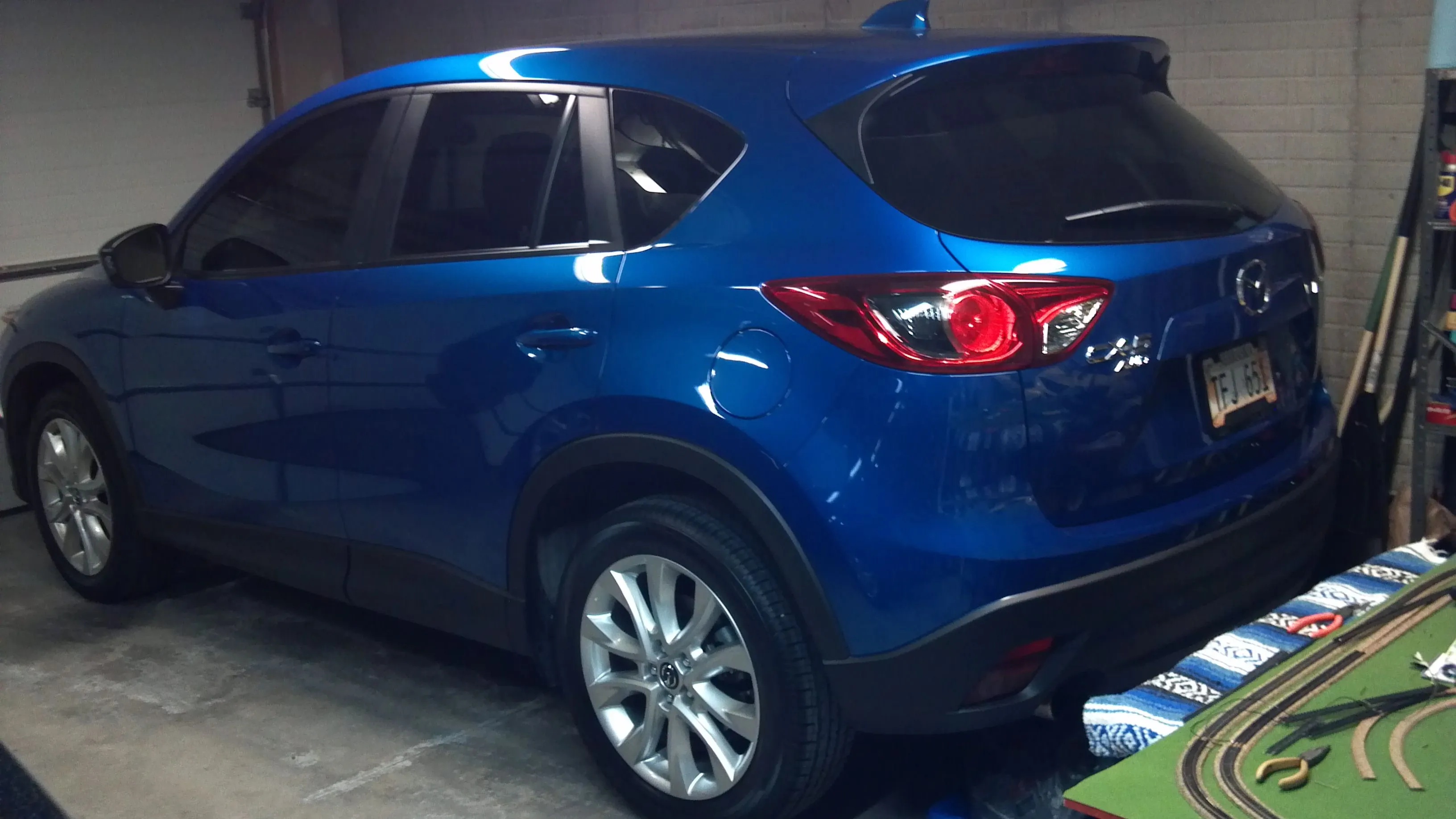

Here is mine with limo tint in the rear and 35% on the front two windows.
^^ now we're talking!!!
Looks like I know what ima do now. Thankyou

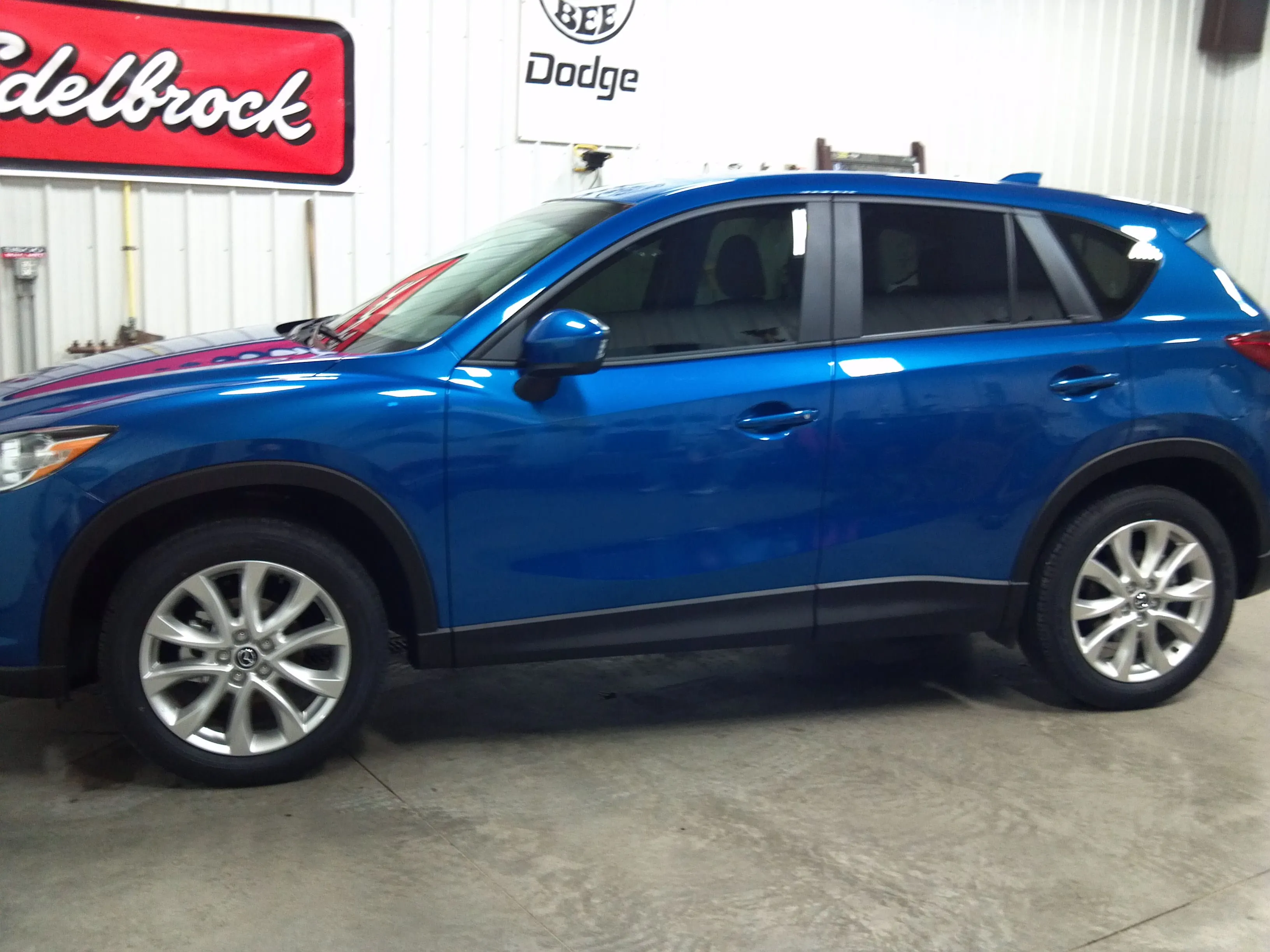

I just got mine done.
Went with 20% so it flows well with the rears.
Couldnt be happier.
Akira - So you did fronts only in 20% to match factory tint on rear windows.

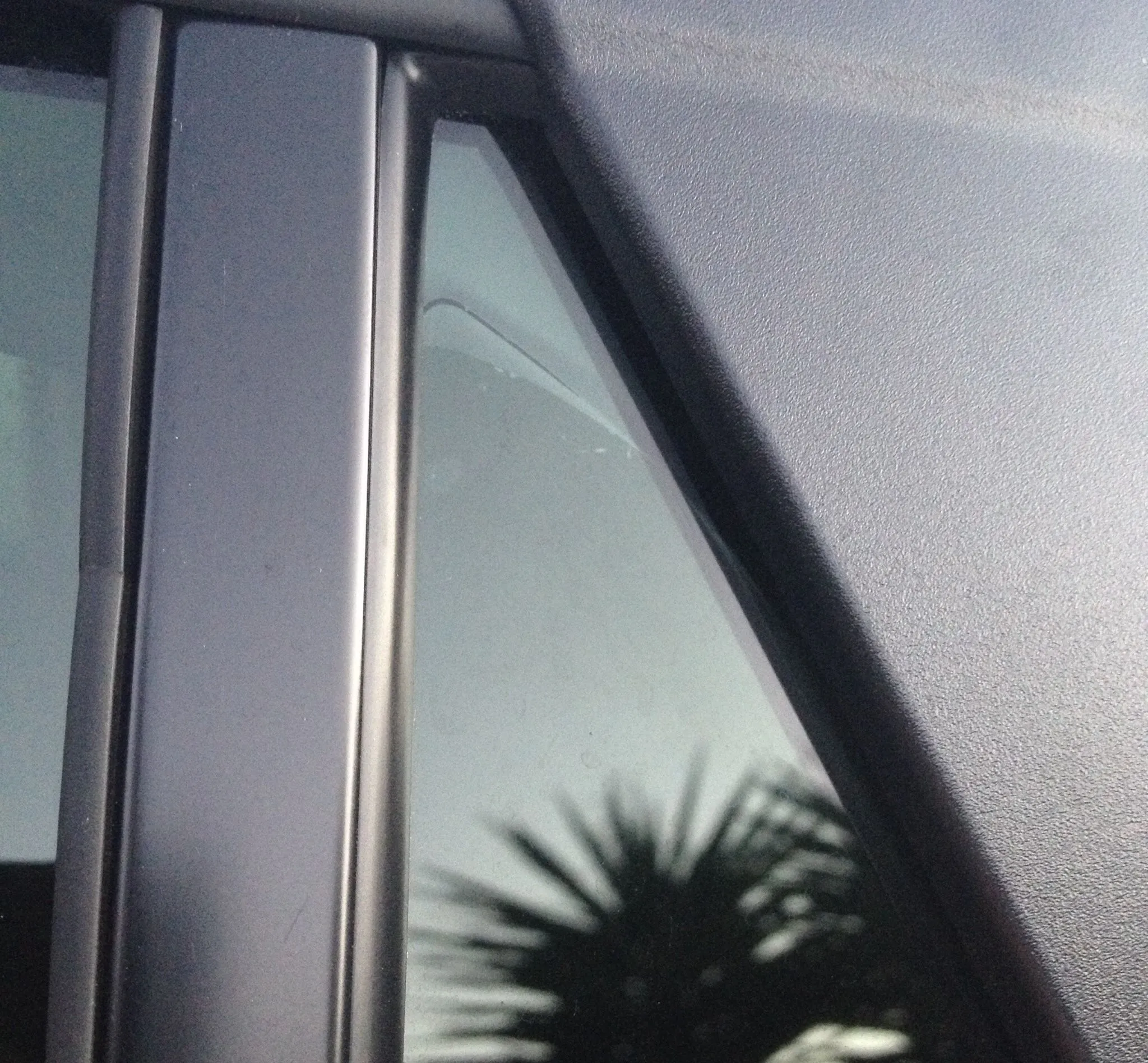

To those that had their tints already done, did the installer have to remove the door panels to fully cover the windows panels?
no. They can not cover the parts in the rear windows that are already black from factory. There is a black outer boarder then some dots as it comes in. They will go as close to the dots as possible without touching. The tint will peal if it touches those parts.
I only had my 2 fronts tinted, and I was there during most of the process. I did not see them remove inside door panels. End result was excellent.

Nothing needs to be removed. What windows are you specifically talking about?
For the hatch and rear triangle windows they will tint on the clear portion of the glass leaving a 1-2mm gap around the black edging of the window. For the front and rear windows that go up and down, they push the weather stripping down inside the window when they are tinting to get below it and then pop it back out when they are done. If you are doing it through the dealer, I'm sure they are using a good quality shop. Most if not all will guarantee the tint for life from anything happening to it either pealing, bubbling, or fading/purpling.
