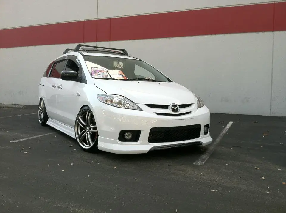

Heres my car with 19" wheels.
The wheels are 19x8.5, offset is at +50. They will NOT fit without spacers. I am using a +15mm spacer which pushes the offset to about +35. They fit great. The rear tucks under, but rubs unless you properly hammer out and roll your fenders and bumper tabs. The front has slight poke. I would run a +38 or +40 offset with a 19x8.5 wheel for it to tuck perfectly in. You'll have to deal with the front fender liner/mud guards, or you can pull them out entirely. My car isn't low enough in the front to damage the fender or liner too much, but it will rub on a heavy dip.

Thanks for the info, and your car looks awesome. I actually just installed my wheels today. I am running a 19x8 35 et in the front and 19x9.5 40 et in the back. I thought I could get back to my house to have the fenders rolled but only got a half mile down the road and I had some tire shreds hitting the fender. I pulled out the old baseball bat and did an emergency fender roll. Problem solved. I will post some pics soon.
Here is a pic of the new setup. Also, your 5 is awesome looking. When I was trying to show the wife the potential that these vehicles have, I showed her a pic of yours.
