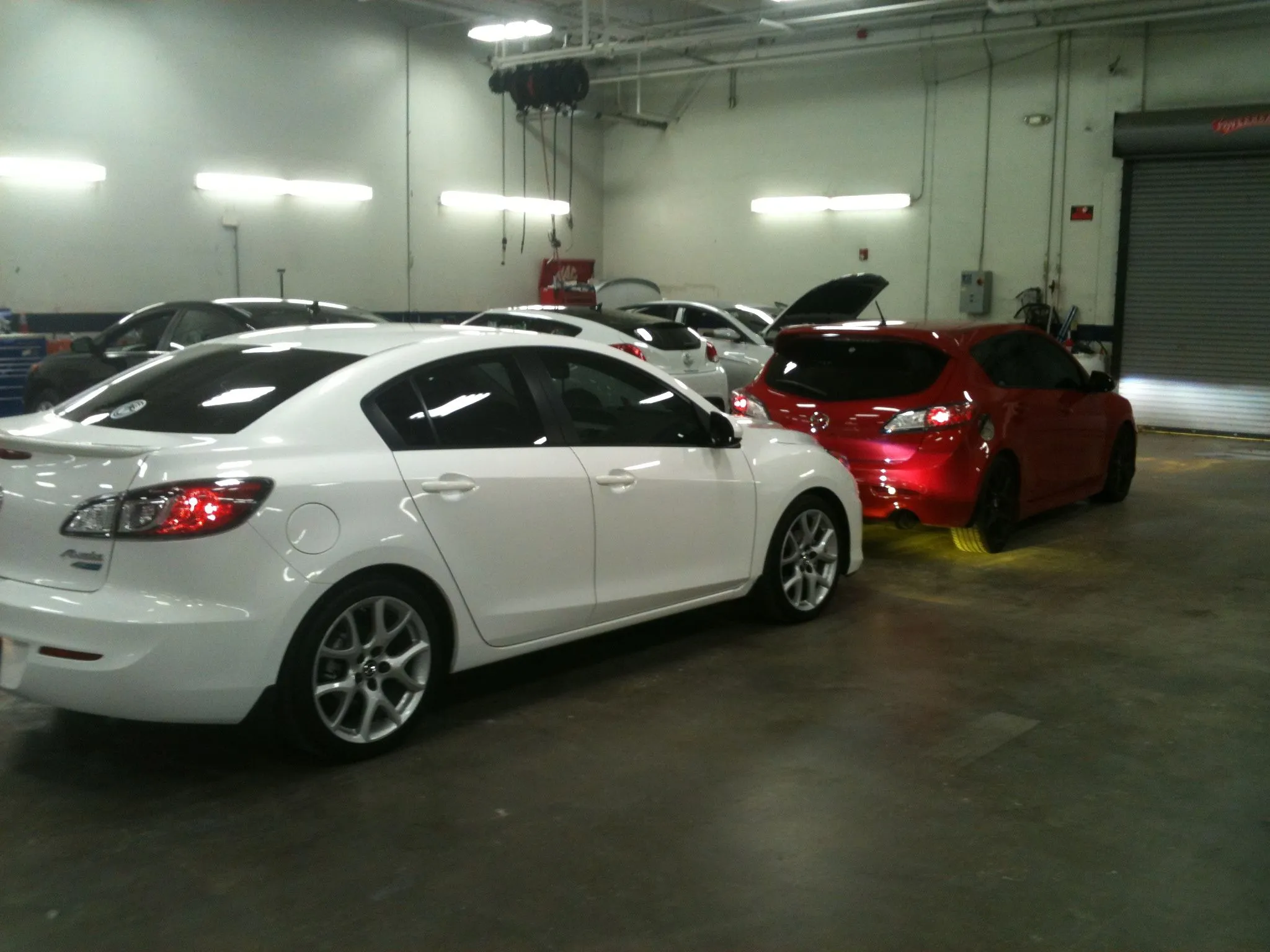

i've searched high and low for cars that really illustrate how bad the difference in drop (front to rear) can be and really haven't found any good examples. in fact, here are some examples for the contrary. both of the cars below are 2012 skyactivs with road magnet 1.25" springs all around. they look plenty level to me!
