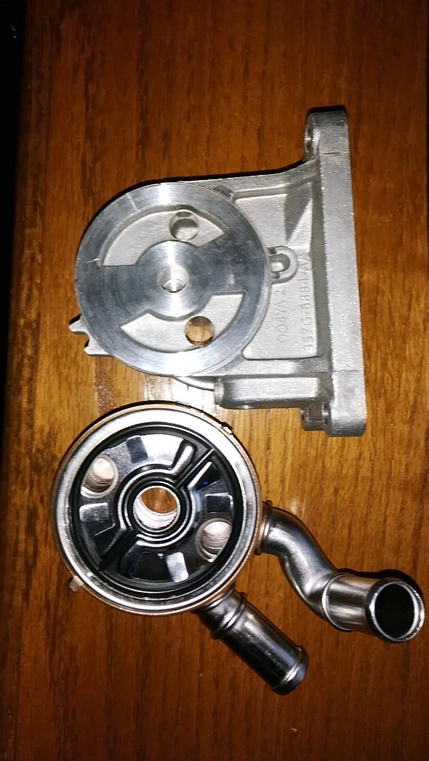

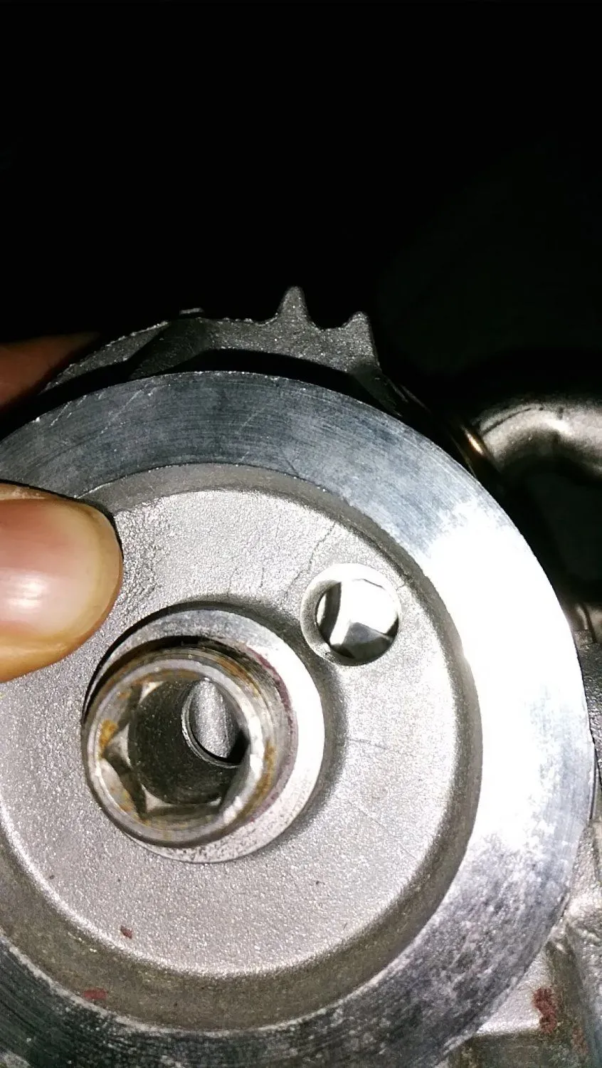

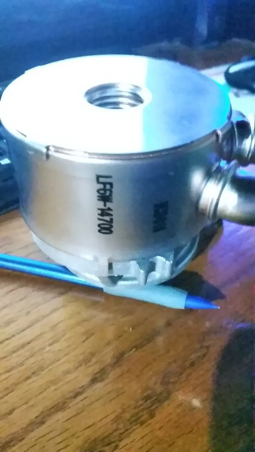

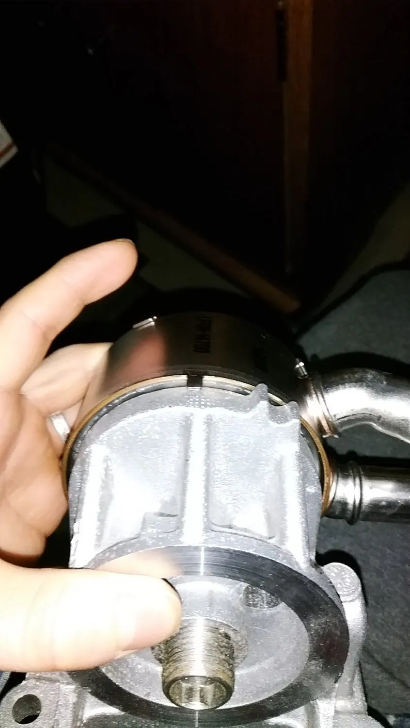

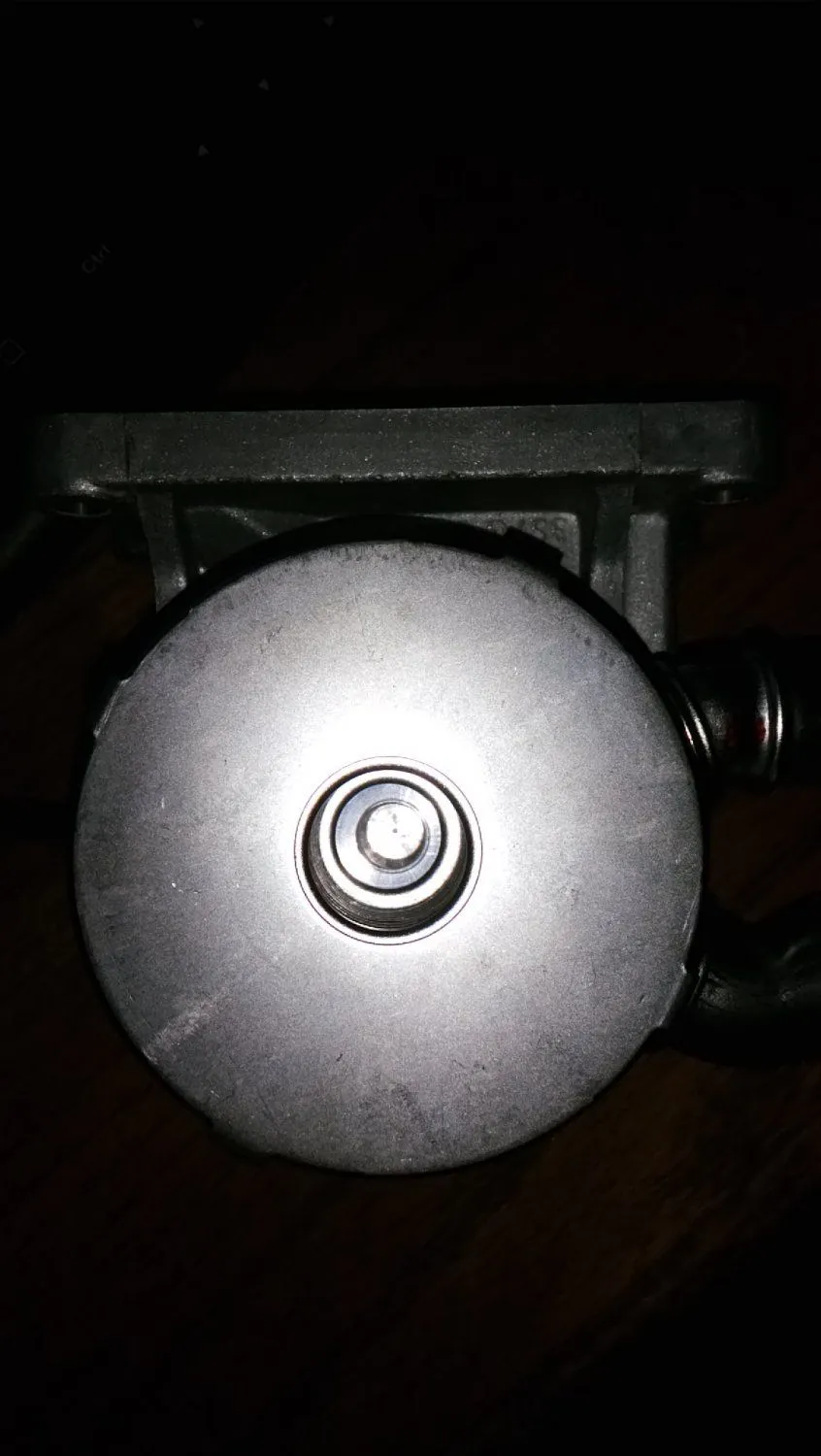

Comparing the two base plates:
By silentnoise713 at 2011-11-26
