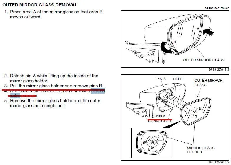

I attached the removal instruction from the workshop manual. (just ignore the red strikethrough)
It seems that if you remove the mirror and see two unused connectors, you should be able to just swap the glass with heated glass.

My 2005 Mazda5 came with heated mirrors. They are activated using the rear-window defroster switch.
