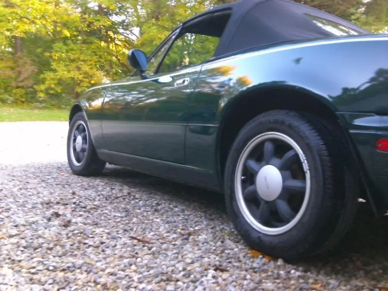

I will have a set of 15x9 6ULs in my possession after this weekend................ they will probably get stuck on the 2 for at least a test fit to see just how much they stick out (guessing about 2") but they are destined for the Miata.
Went to CT last weekend, picked some wheels for the Miatar from a fellow CR.netter. They stayed on the 2 for a week for S&G, now they're in storage :)
15x9 6UL
