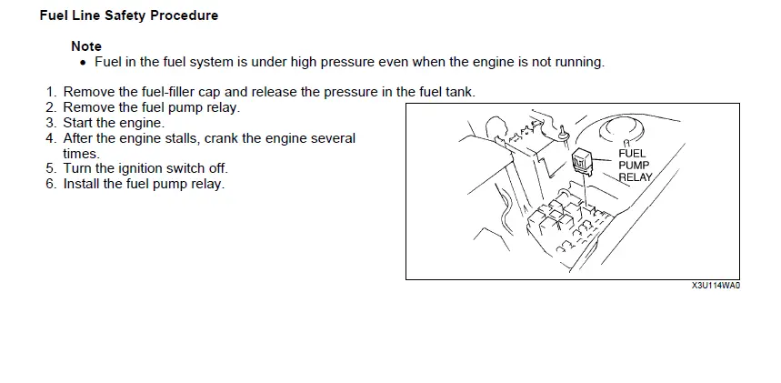

J jbrewer4639 Member Contributor : 2003 mazdaspeed protege Apr 3, 2011 #1 I'm trying to change my fuel injectors. I know I need to unplug the fuel pump relay but I dont know where exactly to find it. pictures would great.

H haveahotcarl Member : 2003 Black Mica MSP Apr 6, 2011 #3 It is in the engine compartment fuse box on the drivers side. I don't have a physical picture, but maybe the line drawing attached will help.
