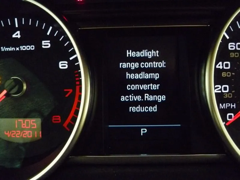

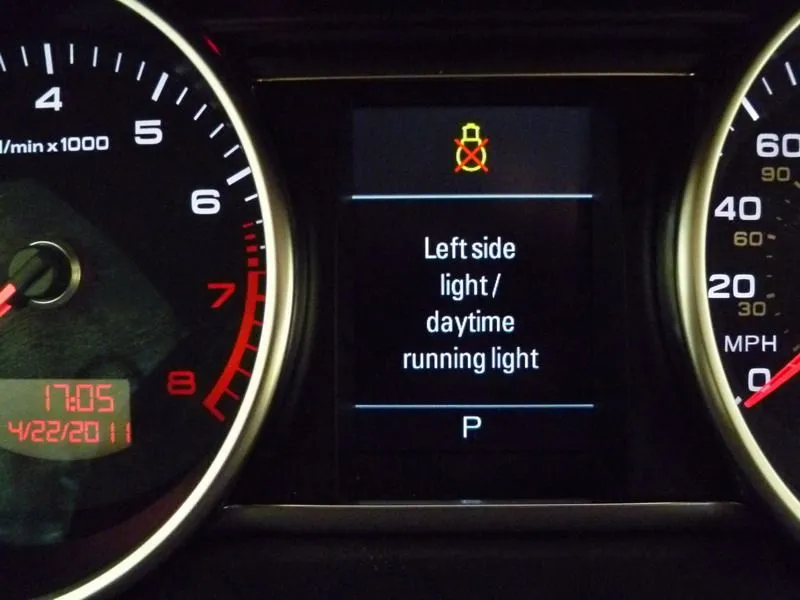

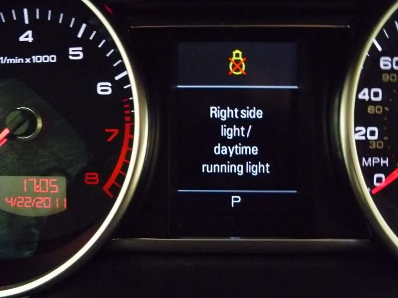

Keep a digital camera ready and take a photo of the warning light, so you can show the service department.
I did just that last week with my Q7. Service department quite pleased with my photos--allowed them to diagnose quickly.
