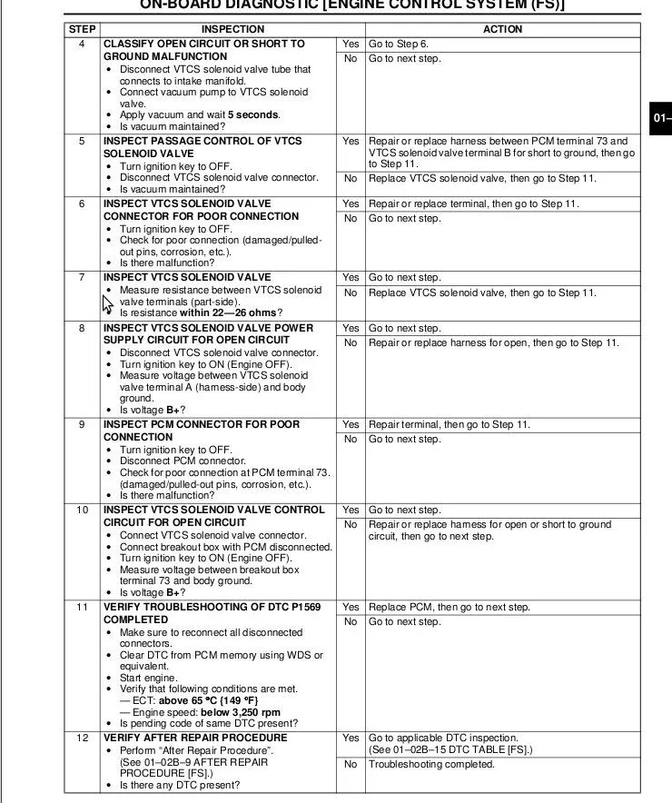

good point, rick. im seeing 1512, 1569, and 1570 as VTC solenoid codes. heres one of the diagnostic pages. basically, reset it, then run the car for 5 mins, and immediately check to see if the DTC is pending... it should be.
So I reset my computer and drove the car for about 15 min and the check engine light came back on pull the code and it still show P2009 does anyone have a picture of that VTCS solenoid ?
