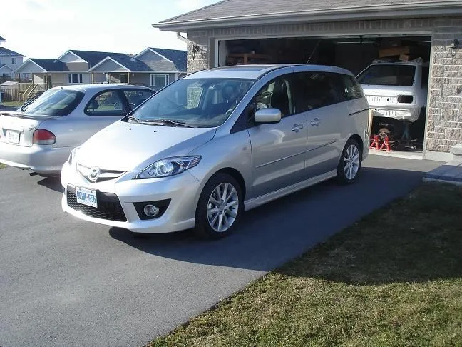

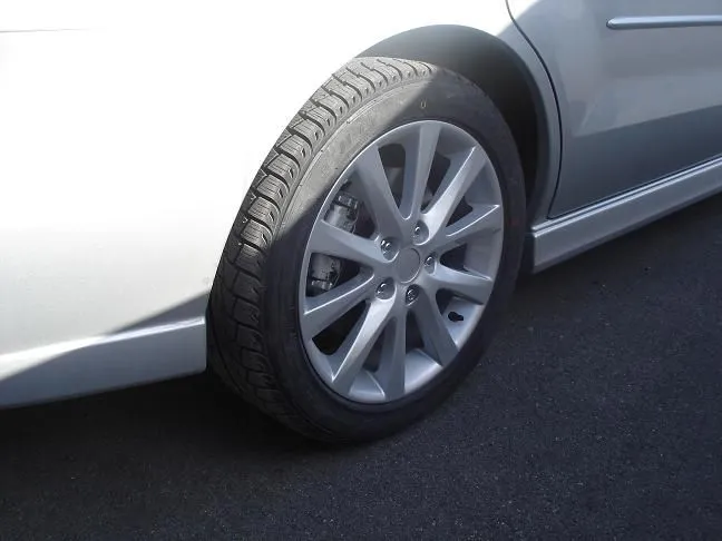

Our winters - Fastwheels Replica - Direct Fit
These seem pretty good. No spacers or centering rings needed, and after 2 winters of road salt exposure, they are holding up fine.

JP, those wheels look great. Are they supposed to replicate the 16 GS wheels?
Thanks. That is what I thought when I ordered them, but I have never seen another Mazda with rims quite like these. The plastic center caps have the Mazda logo moulded into them, but you can only see it from behind (wierd).
