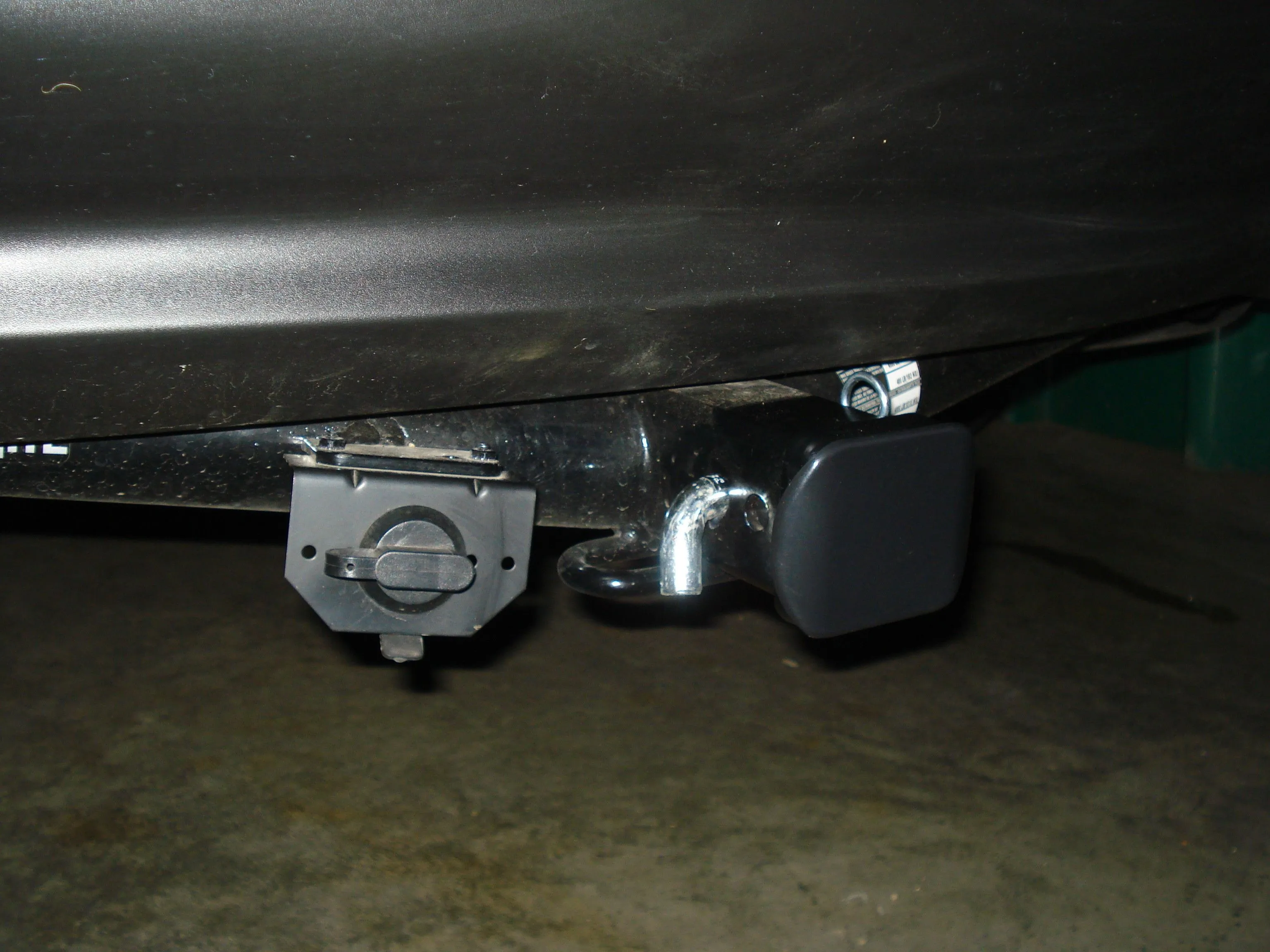

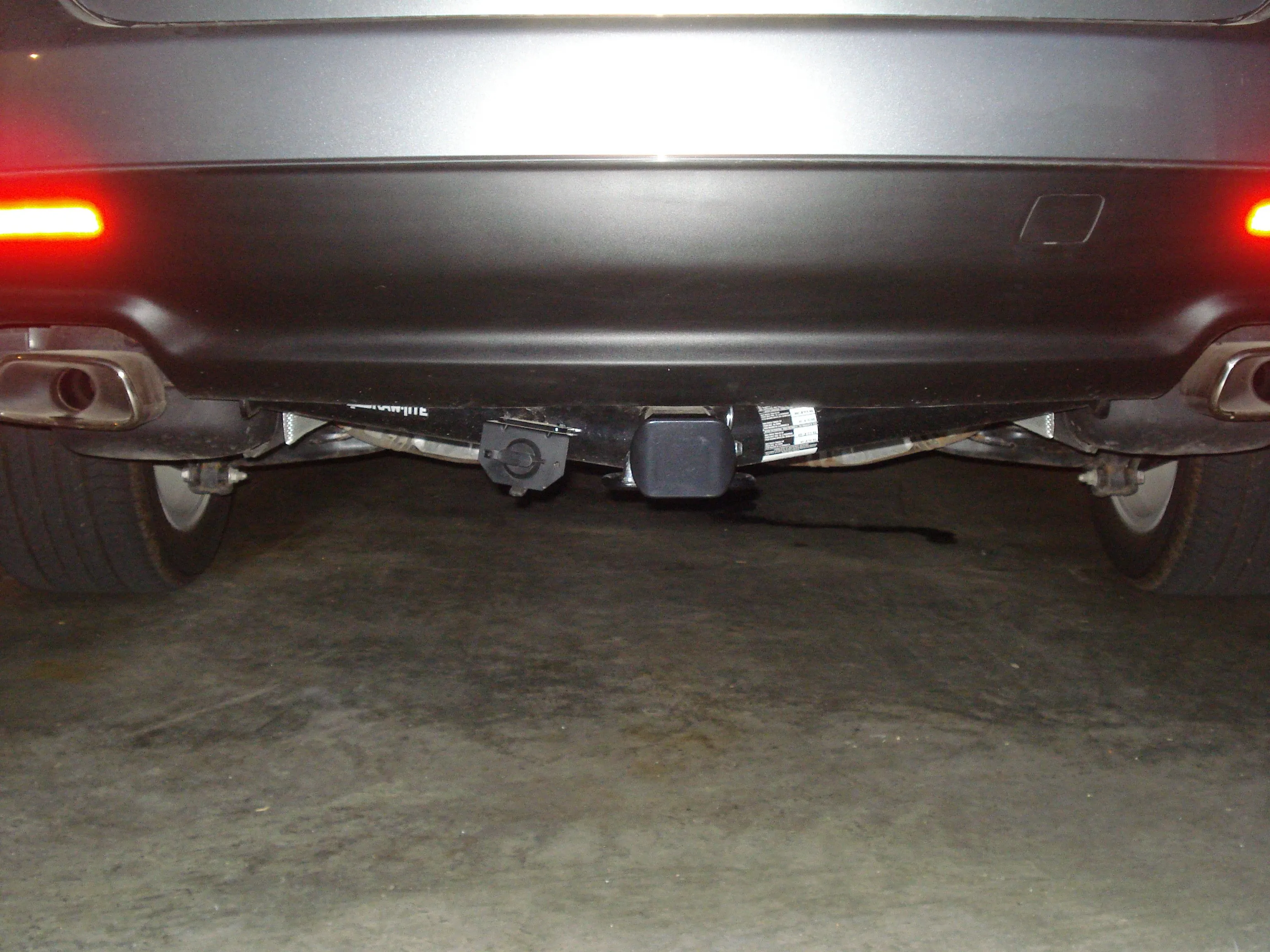

Installed a Hidden Hitch Class III and the Mazda OEM wiring harness on my 2009 CX-9 GT AWD today. I figured I would post pics to share.
Mazda OEM hitch harness part number is: 0000-8E-N13. $61 plus shipping at http://www.mazda-parts-dealer.com This harness should work on 2009/2010 CX-9s all AWD models and FWD GT models.
UPDATE 5/17: Mazda OEM hitch wiring harness install instructions are attached to the bottom of this post. NOTE: The instructions say the harness connector is on the driver side. I found it on the passenger side, so I installed the hitch module near the tire jack, instead of over by the driver side storage bin. (This actually made the install much easier, I only had to remove the storage compartment and the rear threshold plate)
The hitch install is easy - 6 bolts. Used a hydraulic jack to hold it in place while installing the bolts. etrailer.com has a video if people want to see the install
Remove 2 plastic push nuts in the bottom of the storage tray and the whole tray comes out.

Does the receiver have a bracket for the wiring connector, or does it dangle?
Nice to finally see where the factory connector is. Others have been asking about that.
The Hidden Hitch has a small shelf (with holes for securing the connector). I just wedged the connector between the shelf and the bumper cover. The connector has a rubber plug to protect it when not in use. You could easily tuck it up into the bumper to hide it.
The Mazda harness connector is rubber is designed to just clip into the Mazda hitch.
I just installed the hitch and factory harness this weekend. In looking at your pictures, I realize that I placed the harness in exactly the same spot as you and I also wedged the connector between the shelf and the bumper. The only thing I did a bit different was use a zip tie to secure the connector to the tray by routing through the mounting holes.
