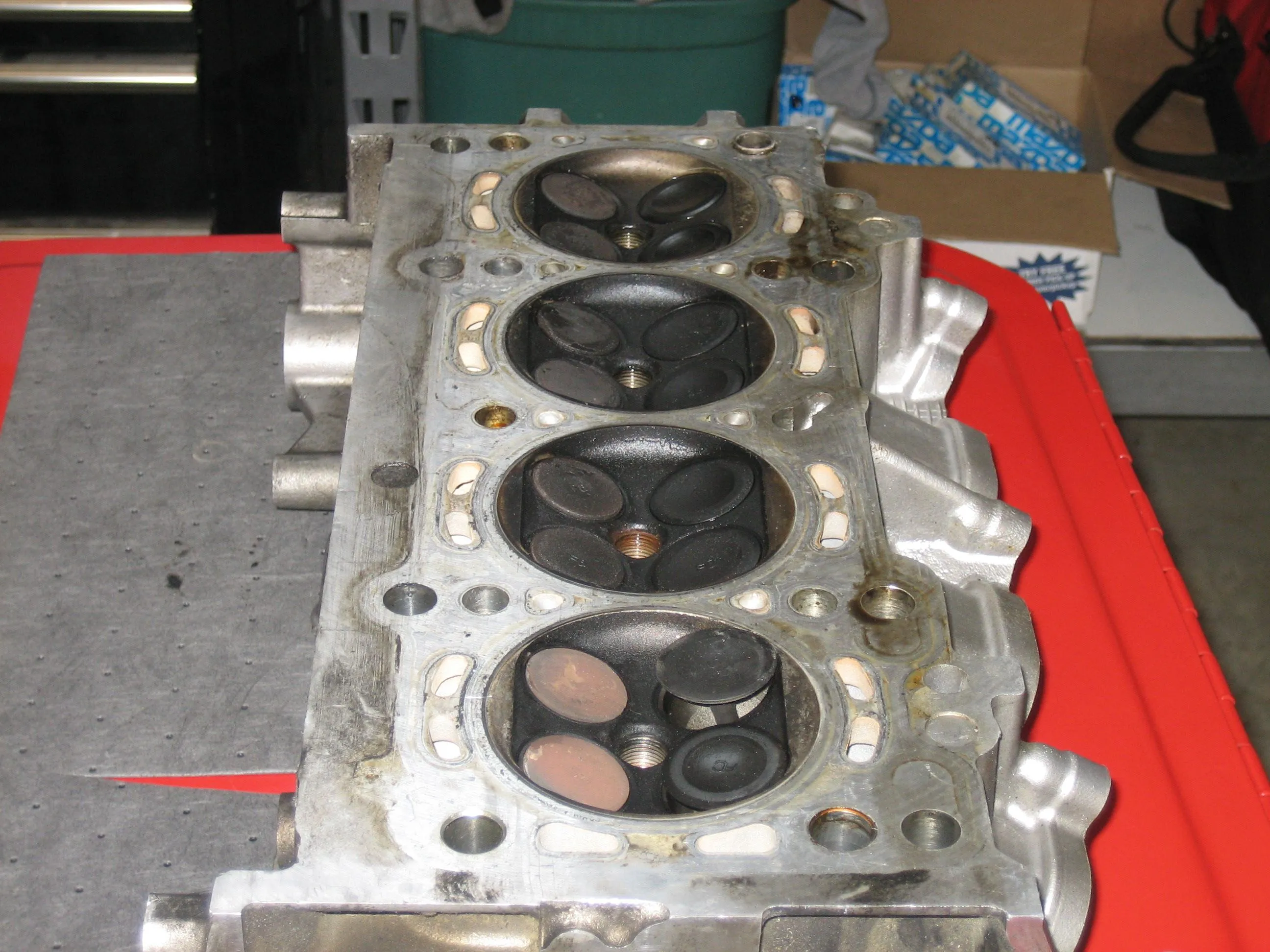

well we'll find out for sure hopefully tomorrow or next week. My boss is having me take in some subaru heads and told me to go ahead and take mine in with them to the cylinder head shop.... to "find out what's wrong with it" (so in other words, I'll be getting a head job)
ALSO ALSO ALSO....... I go to him with my newfound info... "You'll never believe what actually may be the problem. bad valve seals." He says, "Actually yeah I do believe it. It's just like the Ford Escort and those had a lot of occurrences of seals crapping out. It even took out the motor once in a while." So I'm leaning towards the seals and not valves. the engine looks fine (also I forgot to post more pics)

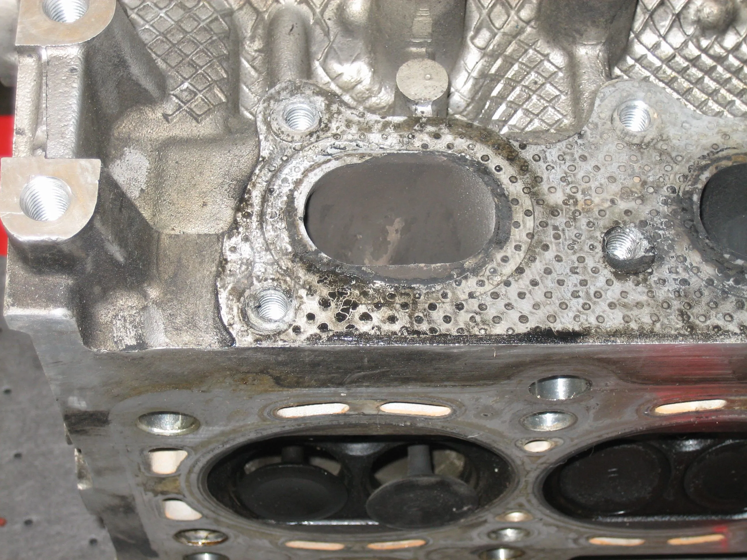

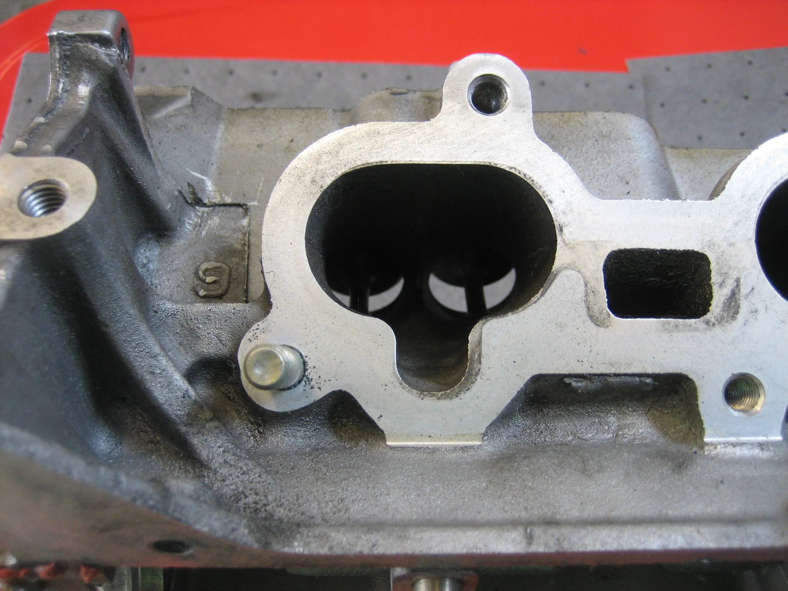

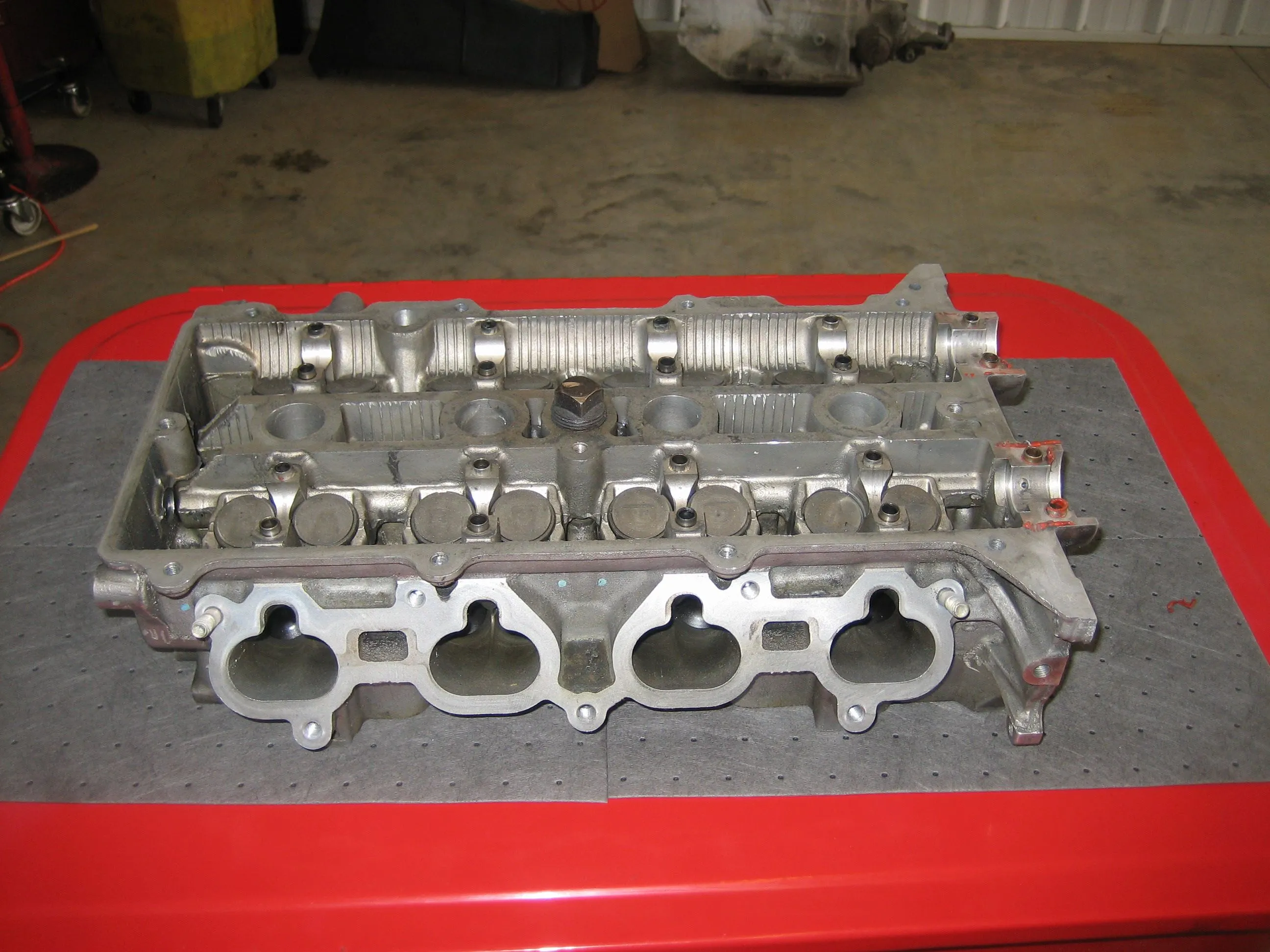

I know these don't help for anything, but I uploaded them so I'm putting them up dammit :B

I hope you marked where what cam went where and all the wafers. If you did not it can be a real pain in the butt to put it all back together after they do the machine work. Im not 100% sure but I think between the cam and wafers their is only like +/- .002 tolerence. I think its like .004 to .009 Just a heads up. Or you could be in the boat like my head was... Bent three valves..........after the head job , I had to buy 6wafers, they are $20 each from mazda, and can only be bought at mazda.
^^ those are called the shims, right? I only had one fall out and I put that back in. cam bearing caps......... no freakin idea. I know they're numbered, but the exhaust ones just don't make sense and that's how I found them. Intake side was fine.
