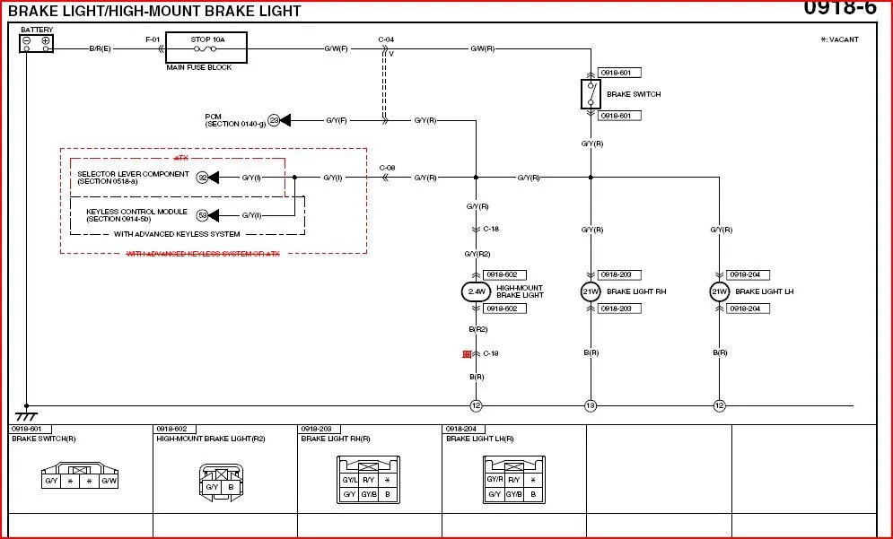

I wonder why there are 4 wires in that connector. The wiring diagram that I got from the internet only has 2 wires going in. For the brake switch.

What do you mean by 'shorted out'?
- The bulbs are burnt out?
- or the brake light fuses are blown?
- or the bulbs simply don't light up?
Anyway here's the drawing from a MZ5 wiring diagram. I have no idea
if this applies to all mazda5s.
good luck.

I mean that the bulbs just dont work. When I turn on my car they are fine. But after driving for a bit they stop working. I have noticed that I can see when this happens by turning on my cruise control. When my cruise control light turns off on its own, I know that my break lights are no longer working. If I turn off my car and then restart it, they work fine again until they stop working on their own. Im at a complete loss. Very frustrated too.
Ok so my brake light are working now which is excellent. However my cruise control still stops working on its own until i shut the car off and turn it back on again.Anybody have any suggestions, or know where to get a 2006 mazda5 wiring diagram?
