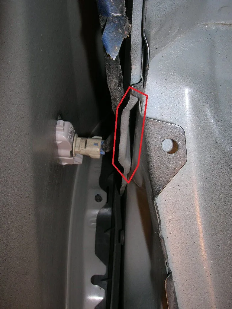

See the link in my previous post, that is EXACTLY where my leak came from. Take off the passenger splash guard and you will find a vertical seam running up the firewall side of the the wheel well. That is your leak location. The windshield is an unlikely culprit. That seam fails and needs to be resealed from the inside.
I added a picture to my original post. Hope it helps.

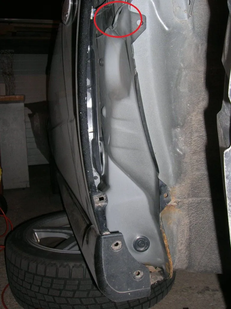

There are two drains inside the cowl, one on either side of the car. Check to be sure there aren't leaves or other junk stuck in there. You can probably feel where the holes are, they are the lowest points on either side of the cowl and drain into the quarter panels and then out. I was able to see them when I took off the splash guard.
Also, the intake for cabin fresh air is in that cowl on the passenger side, if it filled up with water higher than the intake, that's where the water is getting in. And it is probably going through your blower.
I'll see if I can get some pictures tonight if no one else gets to it first.

As promised here are some pictures. The first picture is looking at the passenger side towards the rear of the car. The cowl drain is circled in red. Also note, the wonderful Wisconsin rust on the seam running up and down in the picture. That is where my leaking occurred. The second picture is a close up of the cowl drain, it may be small, but that should be clear of debris.

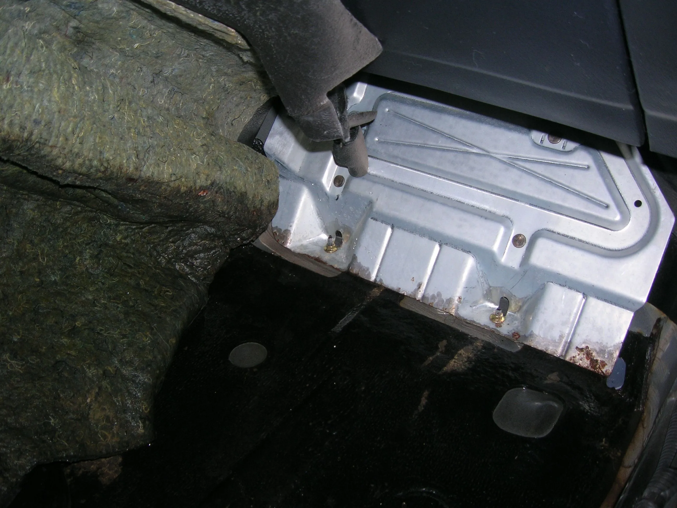

I also found a picture of the original carnage in the passenger foot well, attached just for fun. The sound deadening/cushioning has been removed and it is no longer leaking.
holy s*** thats bad man seal that b**** up!(dance)
