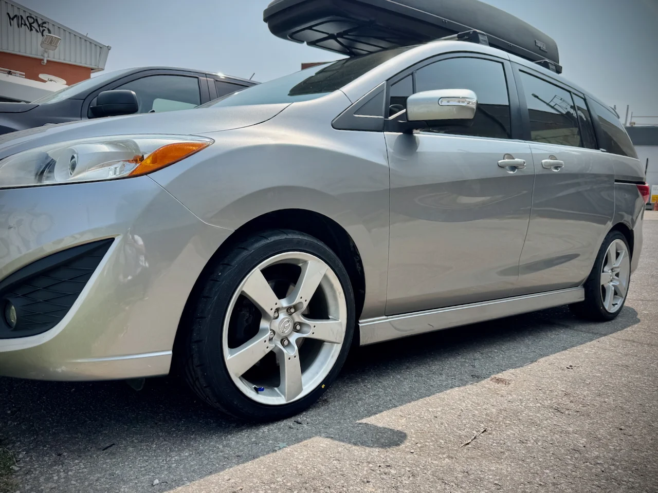

Mazdaspeed3 brakes and rotors, with Mazda3 16" wheels. I did stainless steel brake hoses as well.
Super easy direct bolt in.
