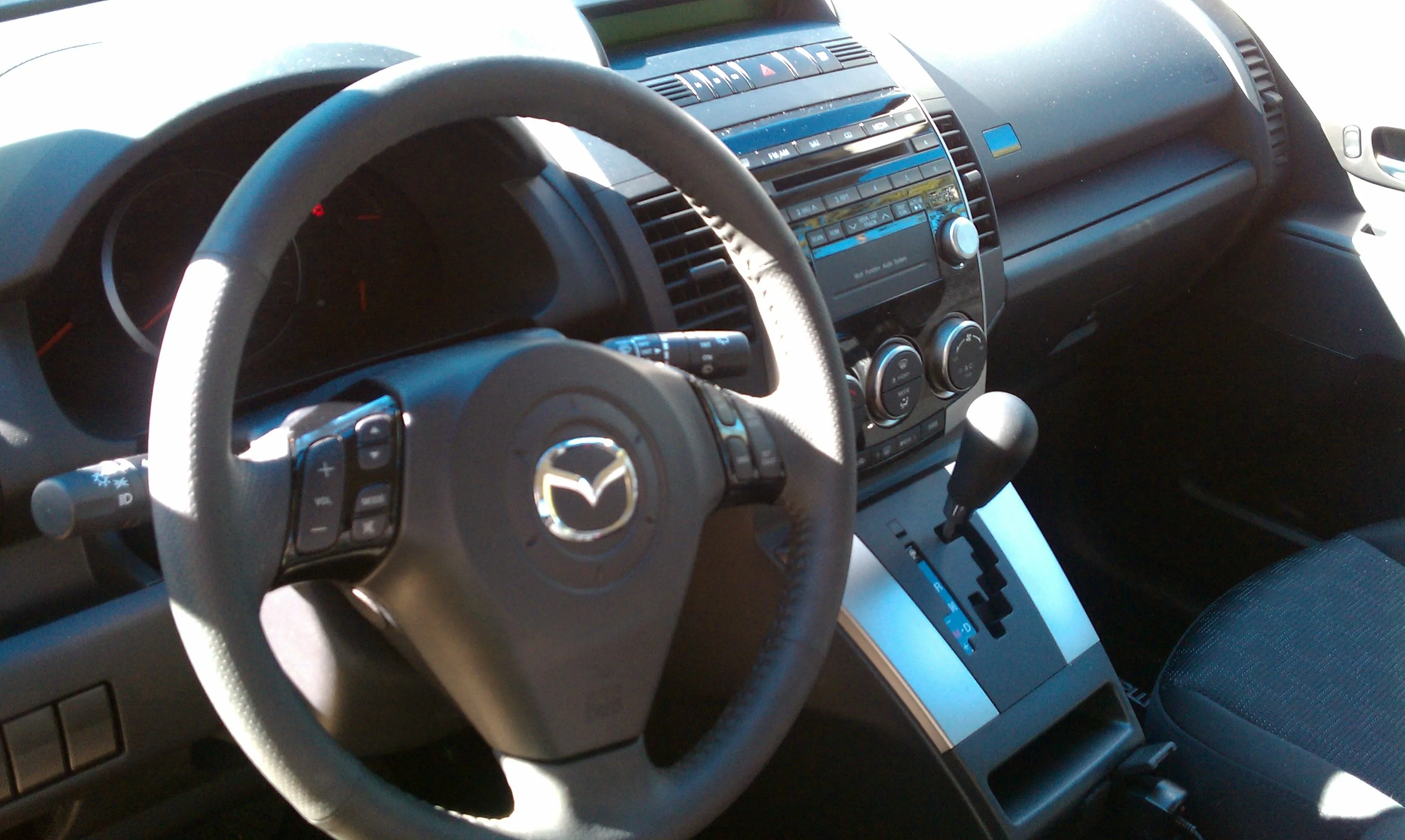

I snagged a leather wheel at a pull-a-part from a 3 this week and put it in this morning. Even has the piano black trim around the buttons to match the center stack. This was the EASIEST steering wheel I have ever put in. Didn't even need the puller. The entire swap took five minutes. If anyone is interested it is this simple....
1) Disconnect battery, wait at least one minute.
2) Remove two rubber grommets on back side of steering wheel and remove two 10mm bolts holding airbag.
3) Pull airbag off wheel and disconnect orange and green connector from airbag. Use small flathead screwdriver or scribe to lift black connector lock on center of orange and green connectors.
4) Unplug white connector from clockspring.
5) Remove 18mm nut holding wheel to shaft and remove wheel.
5) Install in reverse order.
