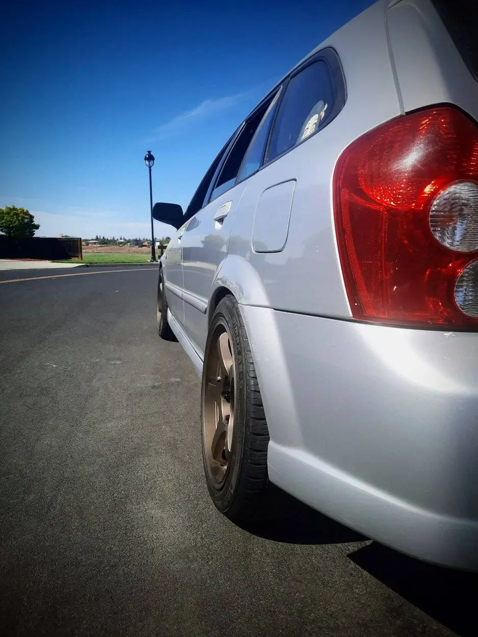

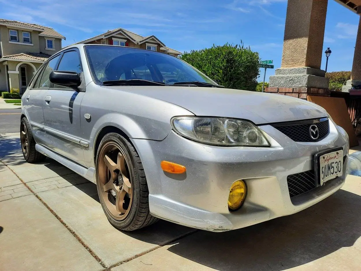

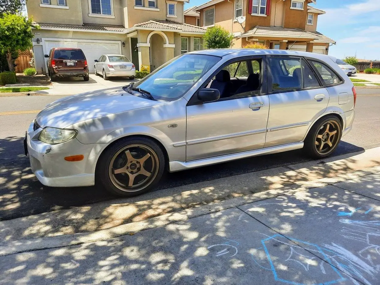

Been a while since I've posted.
Just a quick oil change and tried to fit a freebie set of wheels from my brother.
Looks great but pokes out in the back. I load my P5 a lot and rubs pretty bad in the rear.
17x8 et 35 on 215.45.17. Bought camber bolts and still rubs on near stock Tein H.Techs. I might sell this set and buy a proper set for my suspension.

Those wheels look good! Try stepping down to a 205/45-17 or a 215/40-17 tire. OR a mild roll on the fender might help, too. OR OR a set of adjustable rear controls arms can help pull the wheel inward away from the fenders.

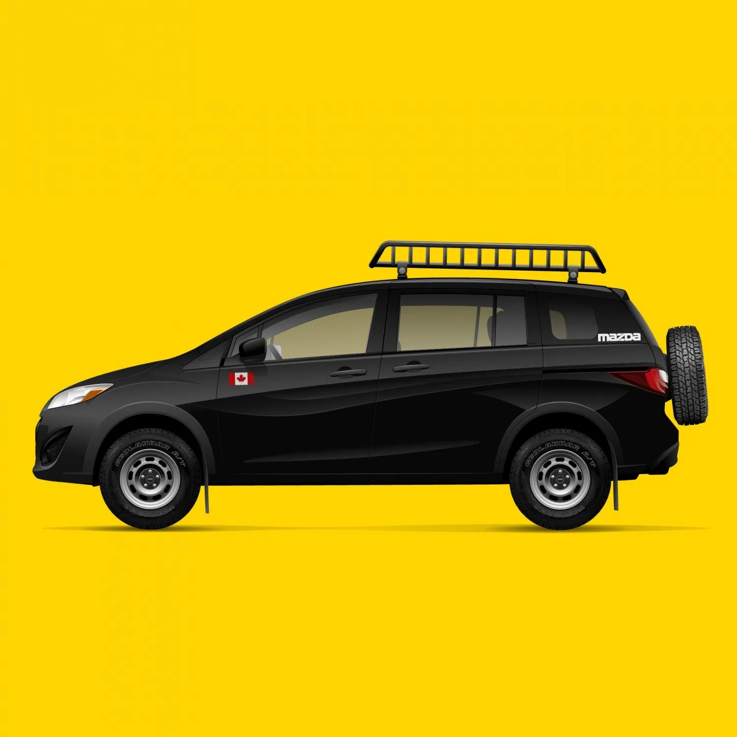

Here's an illustration I did of what I'd like to do to our 5! Our van is in need of new front struts (200,000km on original struts), so I'm thinking of upgrading the springs at the same time. I did some research and it looks like Mazda Tribute front springs would fit the 5's struts. This would certainly lift the front! My rear springs (off a CX7) are already showing signs of sagging, so I may add some coil spacers to help lift the rear a bit more. We'll have to see how well those CV axles hold up and if an alignment shop can get a proper alignment done.
