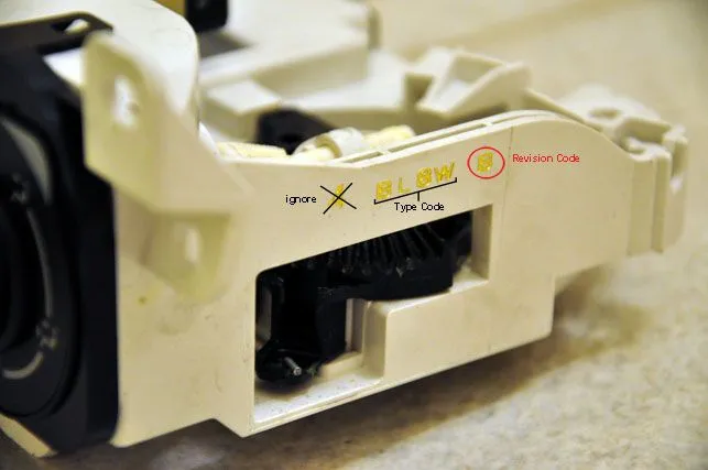

The attached pic will show you what to look for to identify what control unit you have. The numbers are stamped on the side of the unit and is easy to read. If you have read the TSB, you will know by now that there are 2 different types of switches. One is for amber/red illumination and the other for green. SE/DX/LX owners will have green illumination, while the ES/P5/MP3/MSP owners will have the amber/red.
There will be some code lettering stamped on the side of the contol unit. The 4 digit alphanumeric code is the type code identifying what specifically it is. "BL8W" is for the amber/red illumination with the A/C button. "BL8F" is for the green illumination with the A/C button. If you see any other codes, it is either NOT for a 2001-2003 or not have the A/C button. There is also a standalone letter after this code and this is the most important of all as it designates the revision level of the part.
