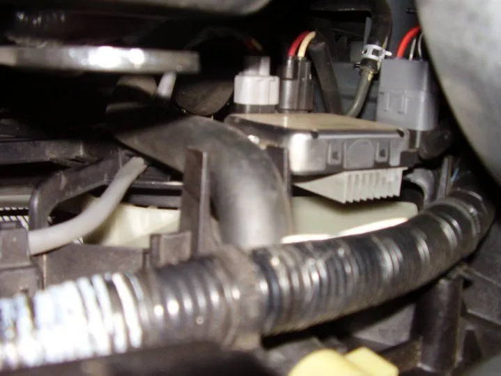

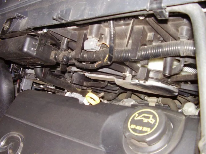

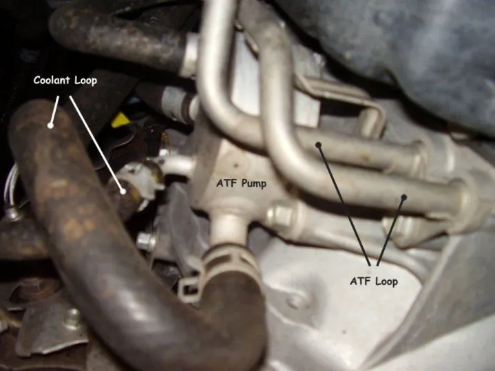

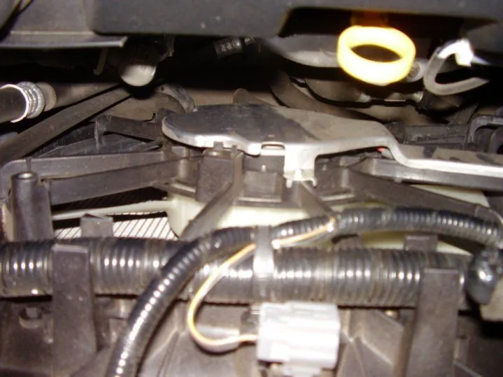

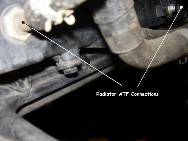

I took a closer look and there is some kind of cooling on the trans. The loop goes into the bottom radiator reservoir, and comes back out. It also passes through what looks like a pump driven by a separate coolant loop.
What I need to look at now is if a CX9 with the towing package matches this. Mazda says the TP includes a heavy-duty transmission cooler and radiator fan. I don't know if that's what I have, or they add something beyond it.
Did you climb under the car to get a look at it? Can you take a picture of where it's located and I can see about getting under mine to see if they match up.
The pump is located on the front of the transmission. The loop goes into the bottom side of the radiator on one side, and then comes out towards the other side.
I'm pretty sure that all looks the same. I had a mechanic buddy come over and take a look and he says there isn't your typical external cooler anywhere, just a bunch of coolant lines coming out. Two that head to the radiator, one that heads back and one that goes up to the front somewheres

I just have a regular digital camera I stick up in there. The other line doesn't go to the front. It goes up into a priming loop, then comes back down and into that round pump.
If yours looks like mine, then all CX9s have trans cooling standard.
If true, I'm not sure what increases the capacity from 2000 to 3500 pounds. Altering the shift points alone wouldn't make that difference.

The first photo with the labels was taken from below the car pointed at the pump. Can you get a photo like that?
