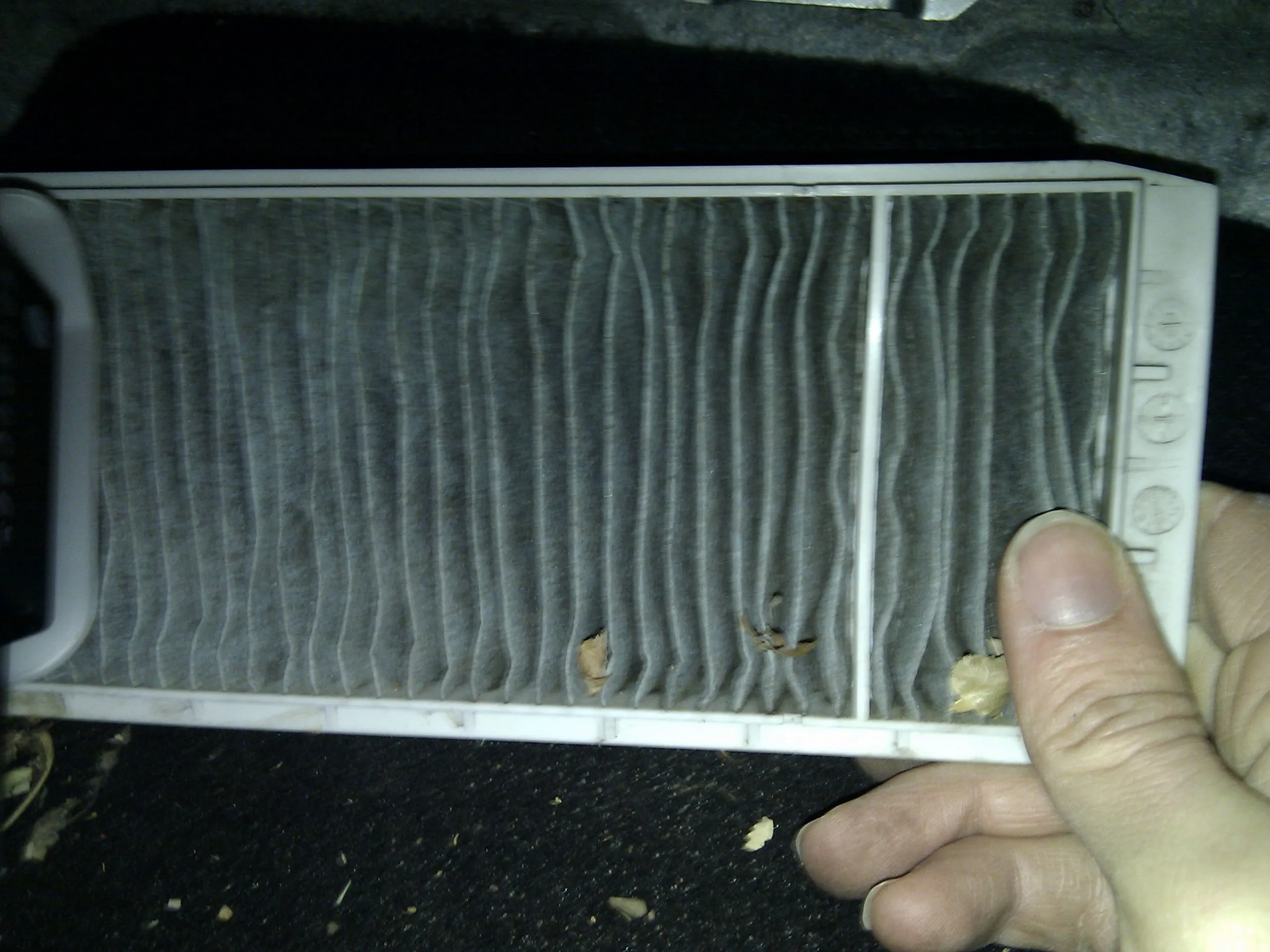

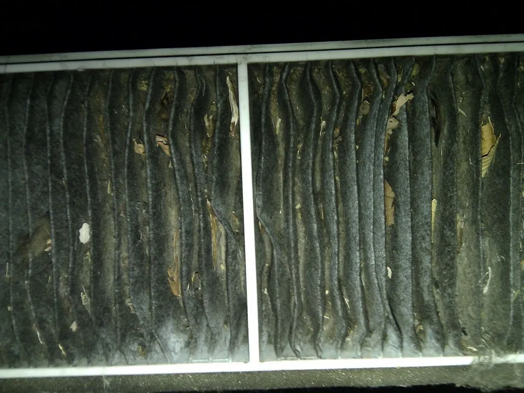

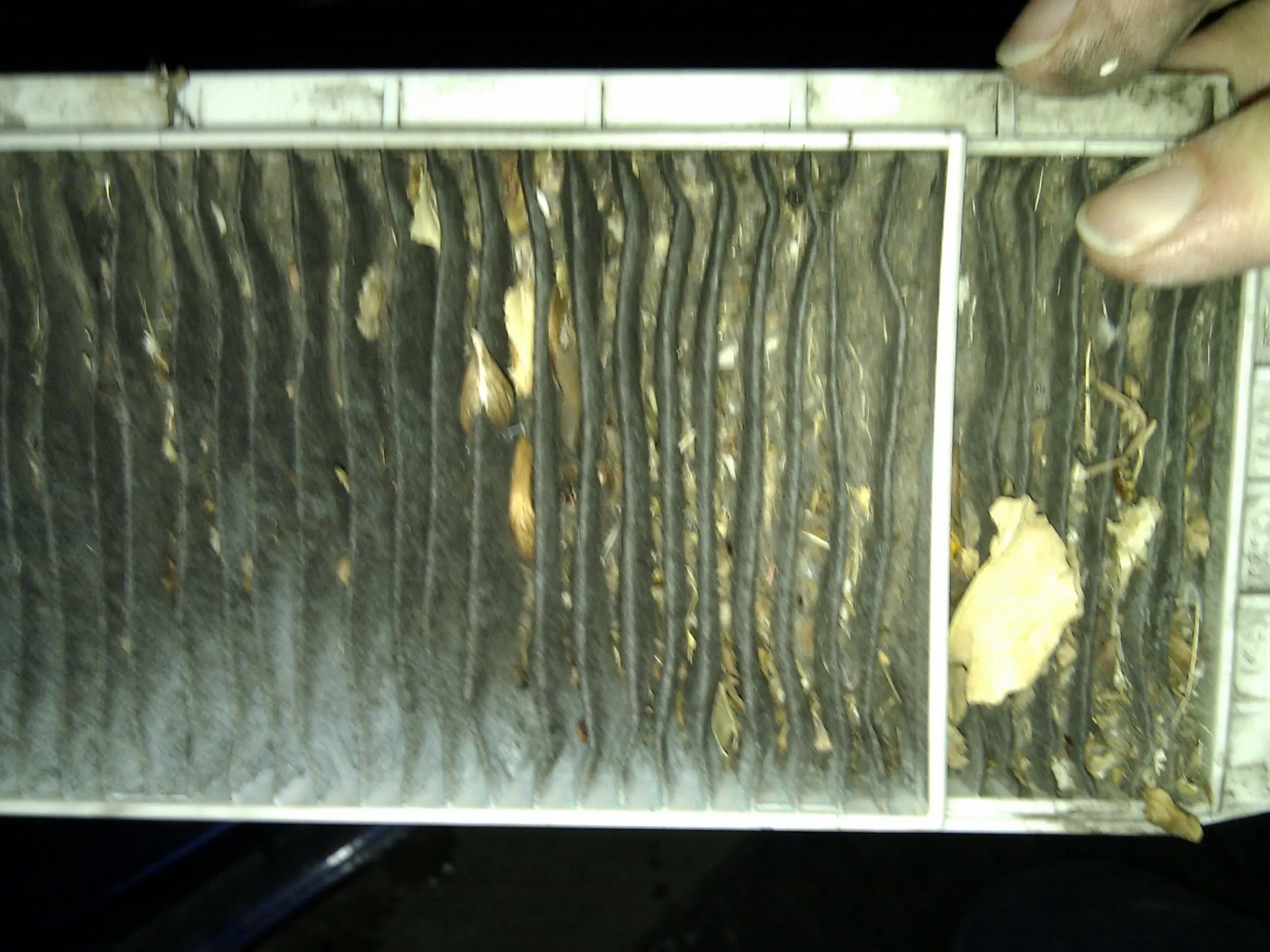

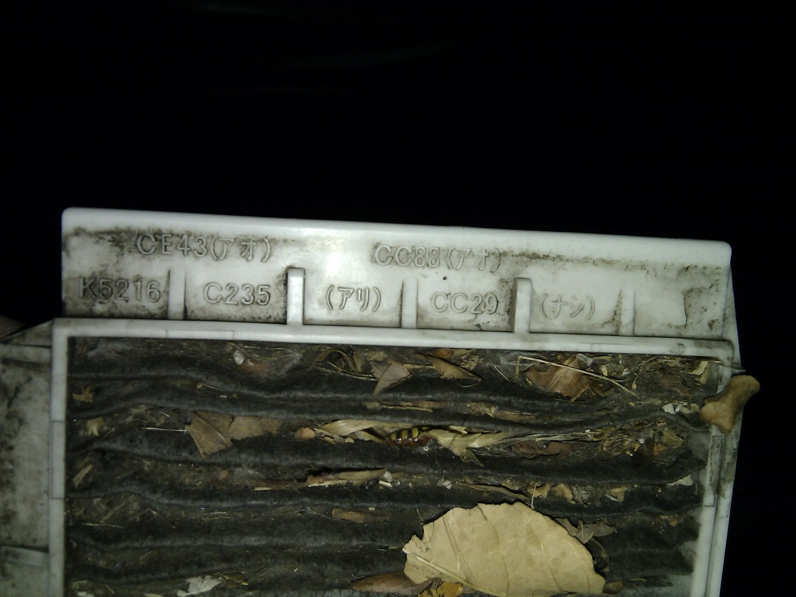

Guessing by the pictures the previous owner never did this
First 3 are the bottom. Last one was the top
