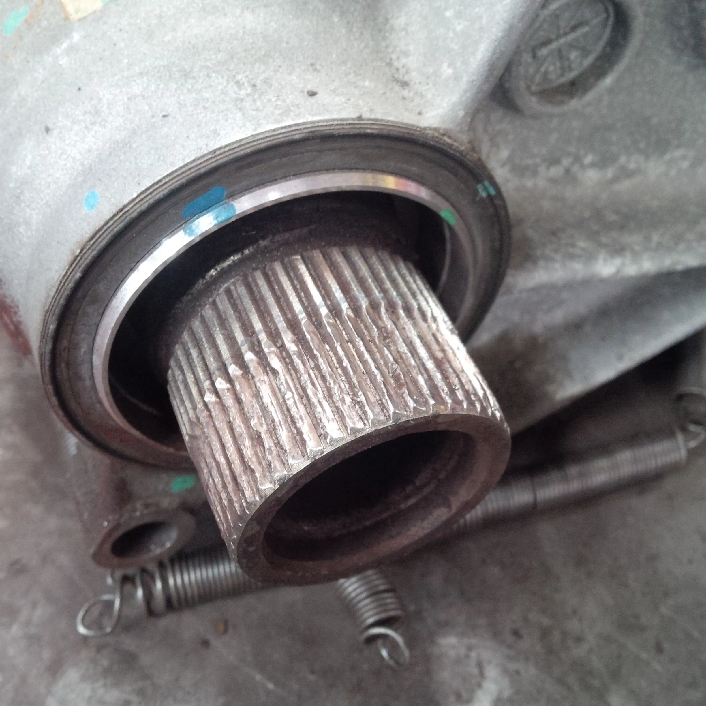

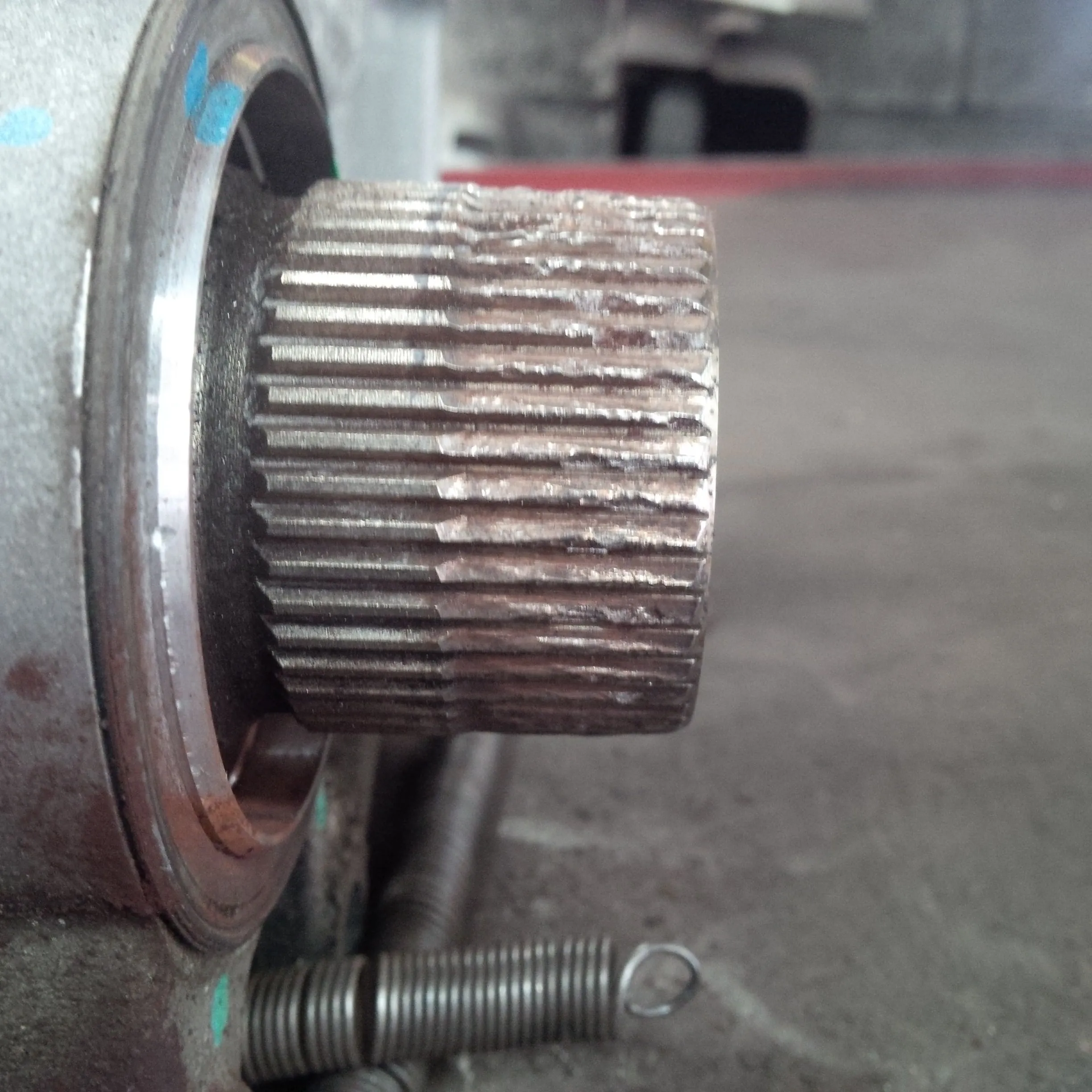

Just got the same problem on my 2010 CX-9, 120k. I bought this car in 2013 with 103k to a Mazda dealer. Maintenance (oil change and tire rotation) were done as per the book at the same place.
Transfer case spline is completely worn out (See pictures attached) and I just learned form the mechanics that the transmission arbor needs to be replaced as well, since it is damaged on the coupling female spline.
Mazda is hiding behind warranty considerations for the TC, and I am awaiting their feedback now that the transmission shaft is dead as well. These should not be life limited parts, or they just should drop designing and manufacturing cars.

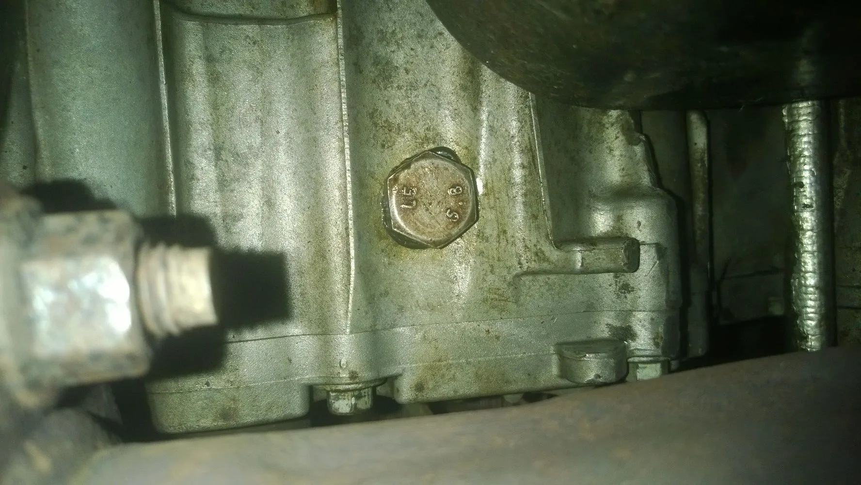

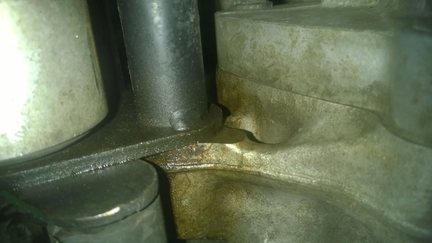

I will add my experience.
I had the same problem, odor, oil was a lot and went out at the top.
sprayed on the exhaust. drilled a hole down to the PTO (PTU). Rinsed and put new oil. So far, everything is fine.
from repairs mileage 5000 km
