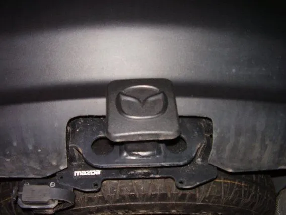

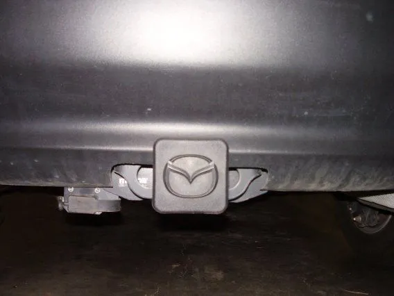

If you have to have the dealer add the receiver, which you should, make sure they do a good job cutting out the rear apron for the tube. I saw one on a lot that looked like the had a badger gnaw the opening out.
When I cut mine out, I actually went beyond the lines a bit to make it easier to install the pin. Pardon my car. It needs a bath.
