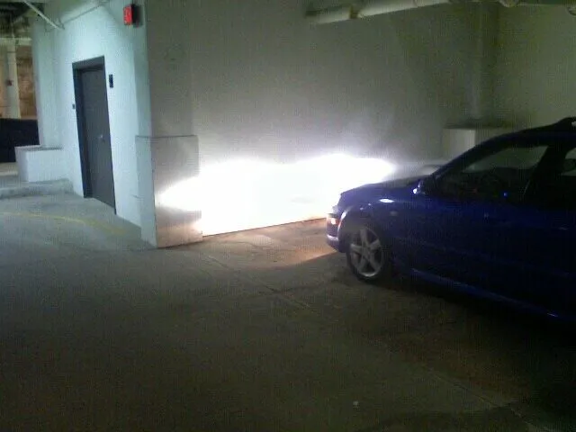

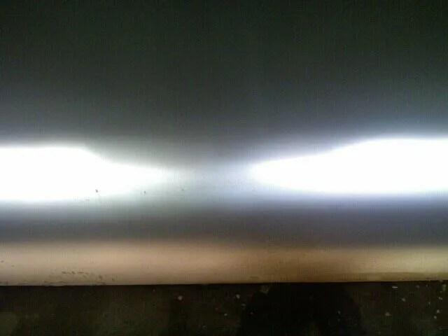

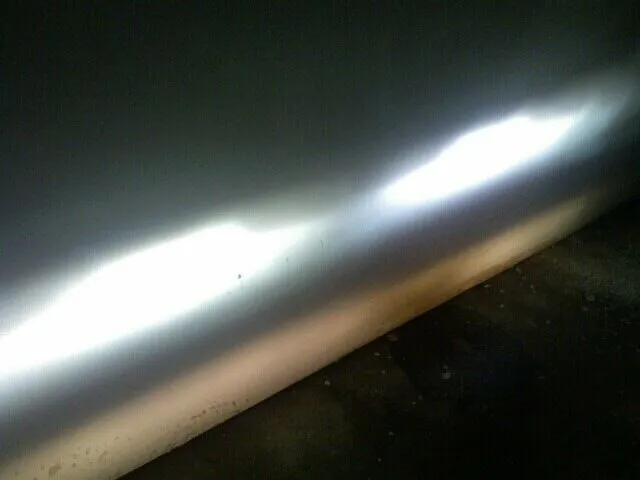

It is hard to take a picture. All i have is the camera on my centro. You can notice a slight difference (there is a blue/purple ambiance on the 5000K (Passenger's side) and it is yellow on the mis-colored bulb(driver's side)) but the lights are too bright and it washes out white for most of it.

Still no word from Xenon_Expert. I'm glad I didn't buy all the lights like I wanted to. I would have paid 150-200 for the parts just to have them work and match the first time around!
It's super annoying pulling up behind cars and seeing 2 different colors >:(
