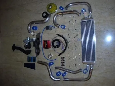

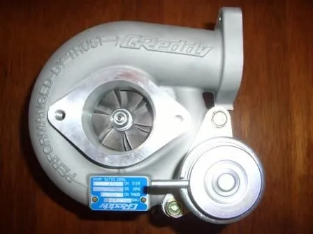

Hey guys, my G-Reddy kit is in and going for the installation tomorrow and then to the workshop which will install the Haltech E6X and complete the tune & dyno.
The finishing on the Trust / G-Reddy kit is outstanding, exactly what you would expect out of Japan.

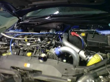

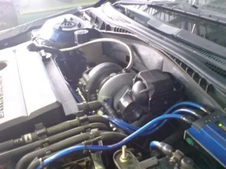

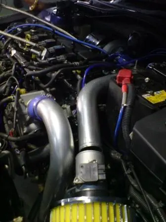

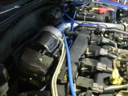

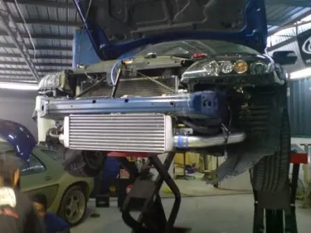

More pictures of the progress

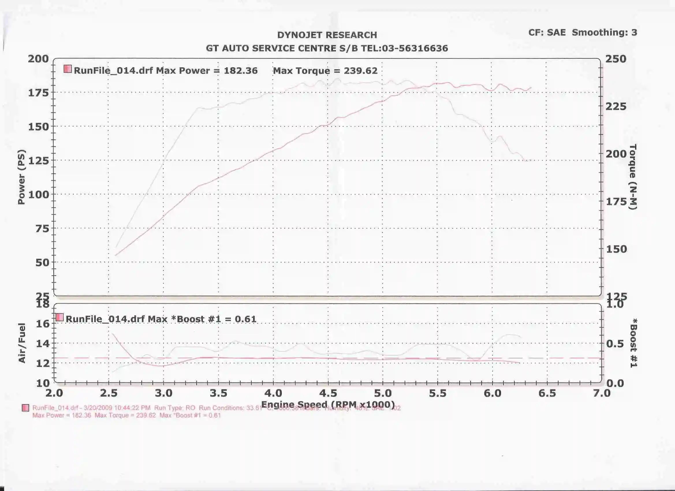

Got it done yesterday and here is the dyno.
Torque comes on real quick as does the spool up but the max power is a little off at the moment. This should be due to the stock exhaust and cats still being in place. The 2.5" Magnaflow should be arriving within the next week or so then will dyno again after the install.
I'm only running 6psi due to the higher compression ratio on my JDM which is 10.6:1

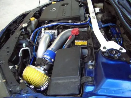

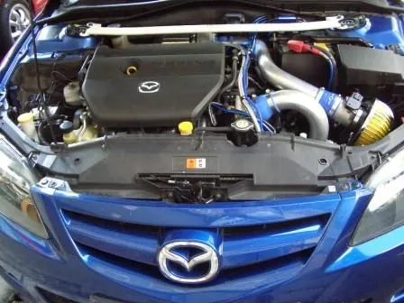

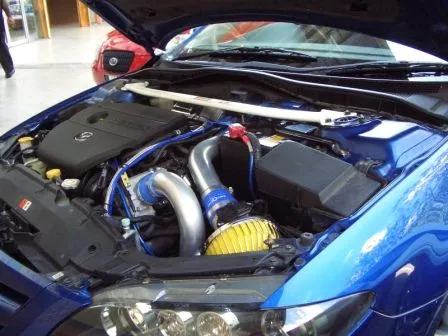

A few pics of the engine bay as it is today (2thumbs)
nice work. how bout some more pics and impressions on your now boosted ride. i wanna see what that intercooler looks like peekin out from the bumper.

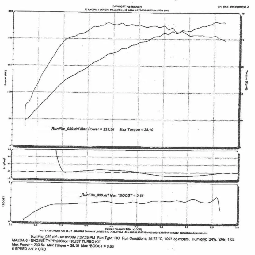

Magnaflow (16609) is now on with high flow cats and here is the new dyno. There was some issues fitting the pipe but the guys at the workshop managed to make it happen.
Will not get the chance to drive her until the end of this month as I'm away on business at the moment. Will get some pics and comments up on the forum and clips on YouTube as soon as time allows.
cant read the graph real well but looks like 233 whp. wow!
oh i see it in your sig now. 275 torque!! day-yam. thats some beef there!!!
