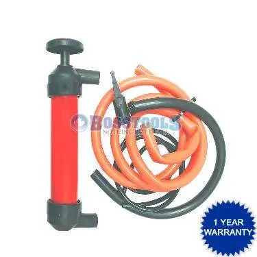

hey guys, does this look like a good pump to use for putting in fluids?
can't really tell, just a basic fluid pump like you can find at autozone for $6 works fine.
