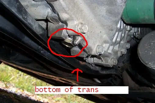

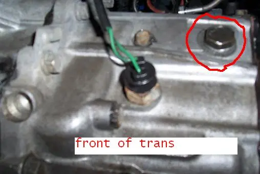

I'm currently in the process of replacing all the fluid in my new/used MSP. I recently completed a oil change and am looking into doing the trans with syncromesh. How much do I need for a drain and fille? Anyone know about this Scotty's transmission cocktail stuff?
I used 75w 90 syntec gear oil and filled it until it spilleed back out the hole. 3 liters or so.
(burnout)
i also filled my tranny till it ran out the hole you fill it in. i used a funnel and a hose to put the fluid in.
