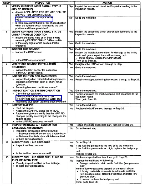

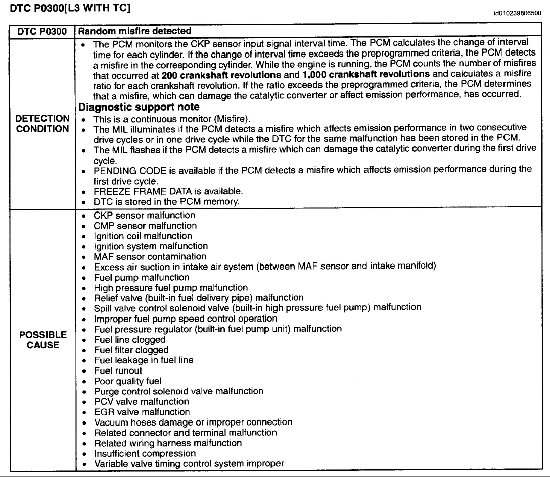

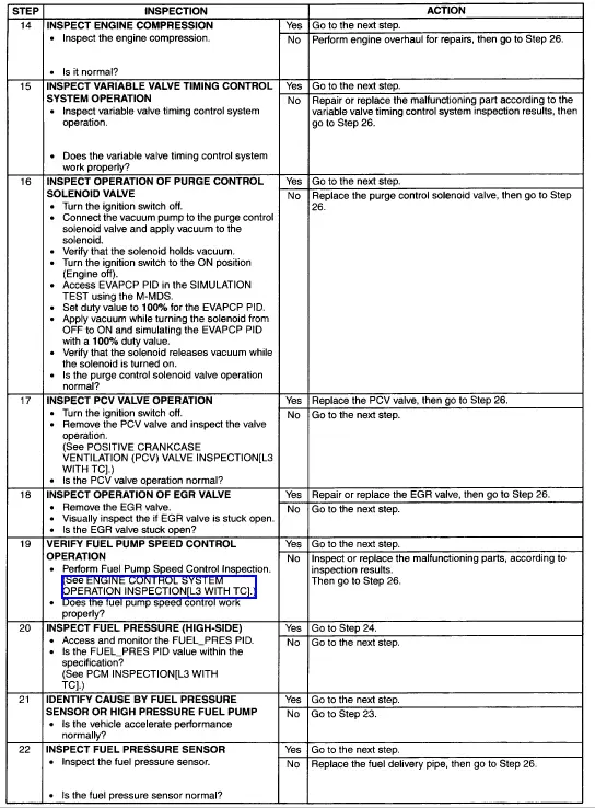

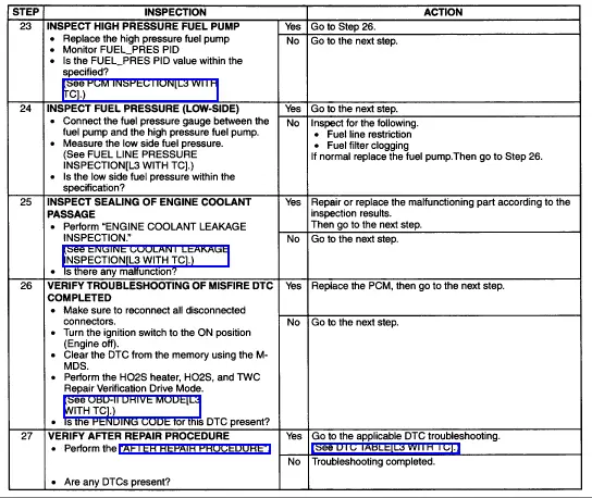

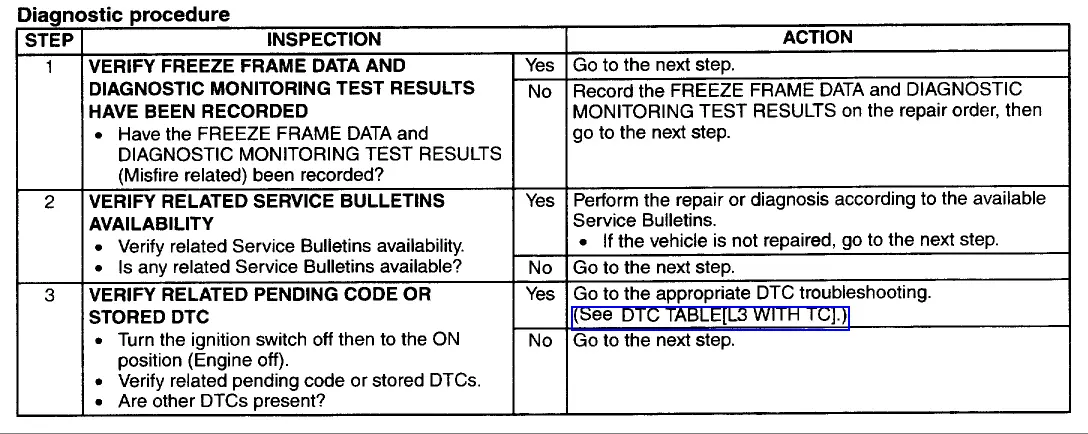

here is the diagnostic chart for the random mis.
te rando misfise will cause the rich at idle, but there is a shitload of things that could be causing the p0300, don;t just throw parts at it like pple are suggesting. this is the exact diagnostic chart mazda is following so tust me throwing a new set of coild and an 02 sensor aren;t gunna fix the underlying problem.
i work for mazda, and we don't necessarily use those charts when we already know a common solution to a problem
