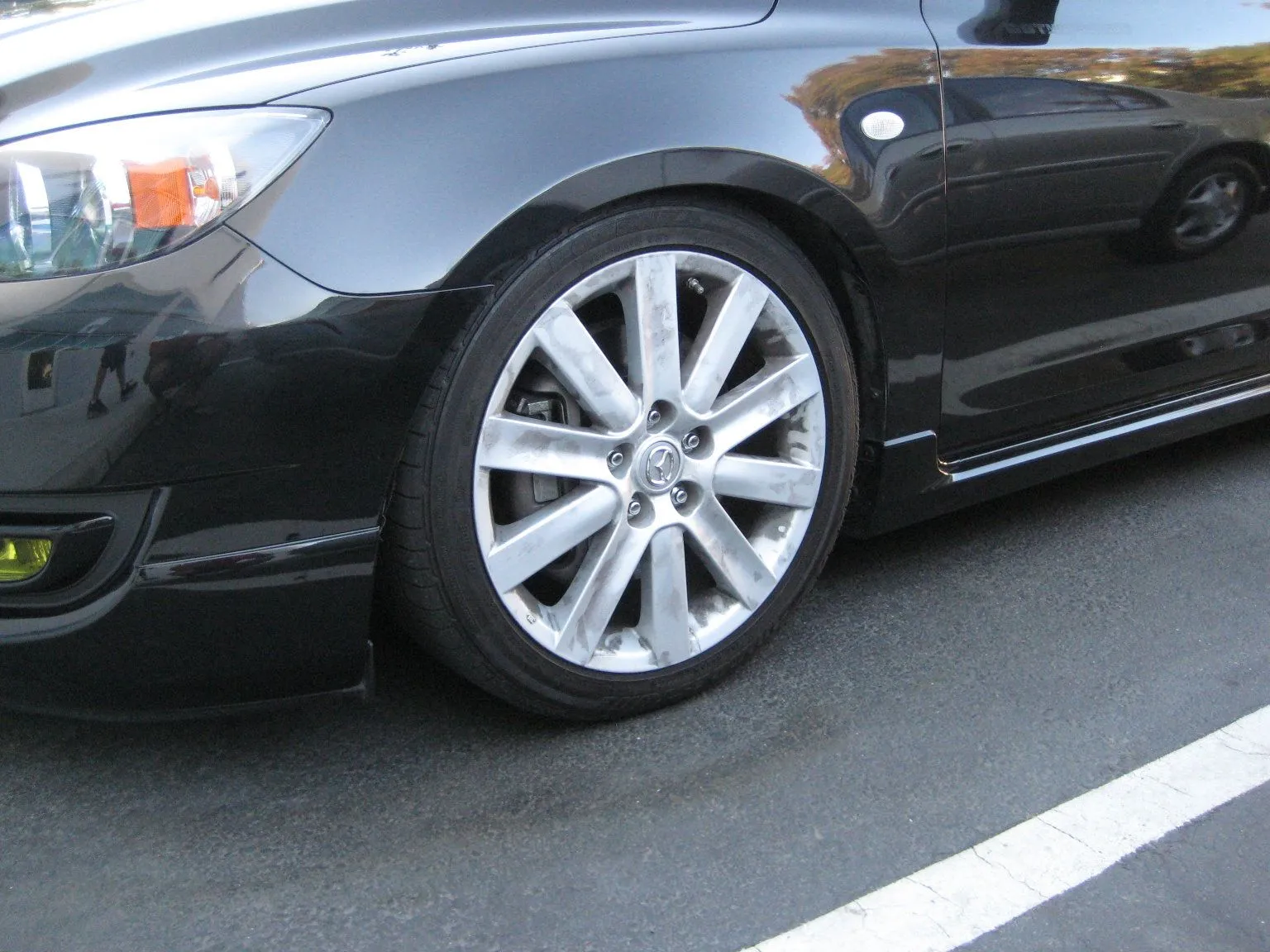

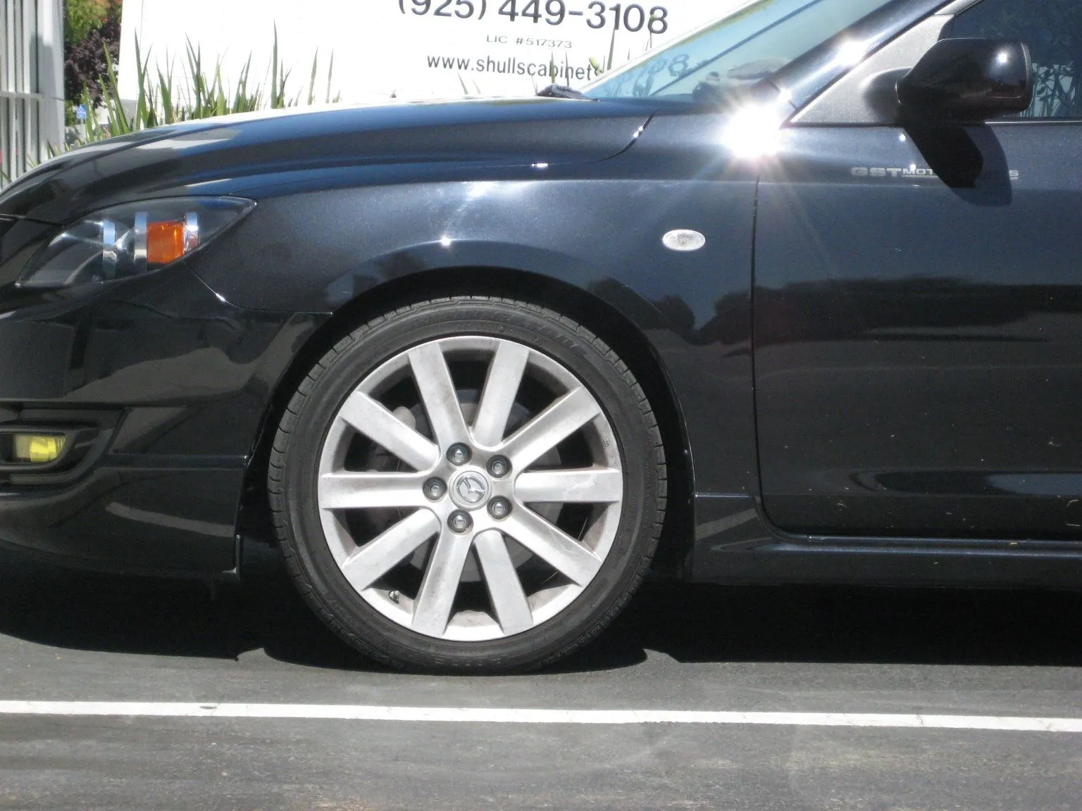

I have BC's and this is low as itll sit without scraping all the time. (sorry for the blurry pics, only ones i have with it this low) Its the red speed3 tucking the tires way up there. Great product all the way around
I dont have it sitting this low anymore
