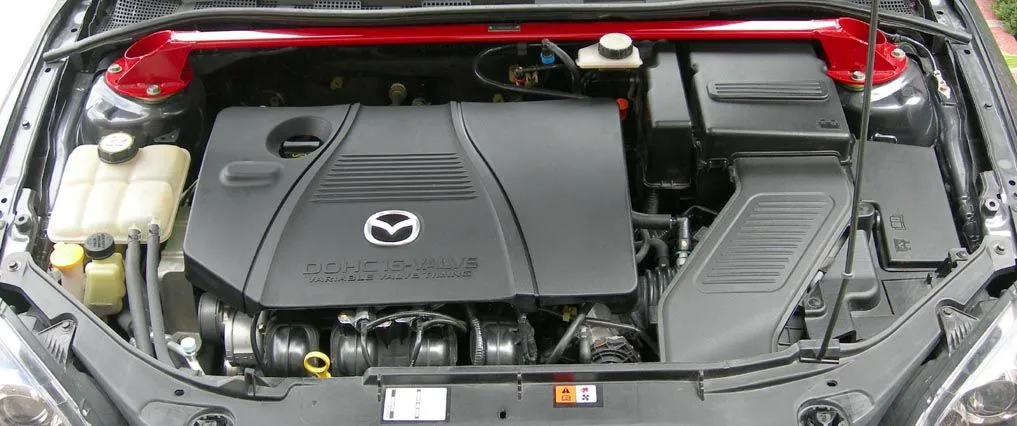

how is that good? it interferes with the battery cooling box which forces you to remove it, it has adjustable points which reduces the stiffening effectiveness of the bar, and the brackets look weak... furthermore, it is located off center which also reduces its effectiveness
not worth the money IMO... I'd take a gt-spec over that one
nice finger btw :p
you can actually leave the battery box in place if you want.
