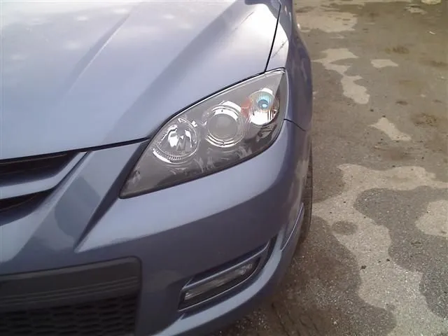

I have done it, and without pulling the bumper. I just took my time and reached around stuff with finger tips to undo the bulb holders. Then reached in with a long-reach grabber tool (cheepo flex thing with a little claw on the end) to pull the socket & wire up where I could reach it. Replaced the bulb then maneuvered it back into place, twisting it back with finger tips. It was a PITA, but possible, took about 15 minutes.
i did it too without pulling the bumper...
just go from the fender liner... undo 3 screws and it will allow you to move it enough to get in there...
it wasnt that difficult. i tried the the sylvania suilverstars, but they gave it to much of a bluish tint during the day, so i decided to just go clear. they look awesome.
