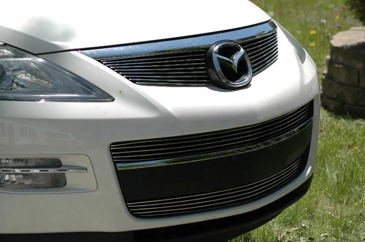

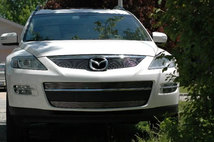

How's it goin' everyone, I also purchased a grill, but I got the chrome mesh version. Installed it today, took me about 2.5 - 3 hours to install because it didn't come with instructions, so I had figure out on my own where to install certain brackets and what not. Bolted right over existing honeycomb stock grill. It looks pretty nice, I'll post pics later.
I look forward to seeing the pics. Where did you find/purchase it?
I found it on ebay about 2 weeks ago. I think someone posted a link to it in this thread a few posts back. I'm not sure, but it looks like they may have had only 1 for sale (for now), and I got that one. It doesn't show how much they have/had in stock.
I'll post pictures this weekend.
Here's the pictures of the chrome mesh grill I installed a week ago that I bought from eBay. Sorry 'bout the picture quality, but I took the pictures with my cell phone camera. I think it looks okay, I prefer mesh over billet grills.
