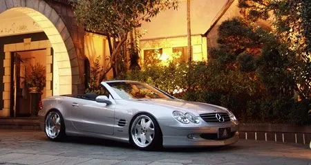

I want to see these on there so bad!! Those wheels are going to look sweet! I love those and the Locksmice "Gerade" .. Not sure we can get the Locksmice in the states.
The closest I've seen is auto couture's...
