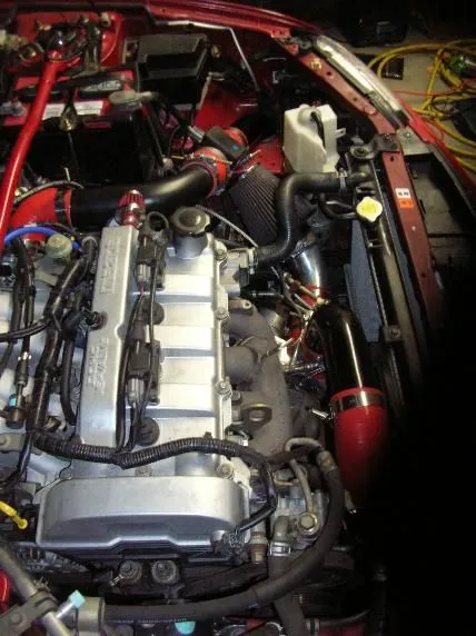

I finally finished installing a FMIC, I installed turbo, fm clamp, fmu, gauges last month.
Here are some pics.

5psi right now till I can get on the dyno, I also dont have a boost controller. hoping to hit close to 190hp by summer. Just need a few more goodies- AFC, dyno time & Boost control.
update: Engine Still running good at 5-6 psi too bad roads suck right now,
the Trans is starting to slip a little might need to rebuild it, hopefully it makes it till summer.
Trans is on its last leg now, slips every gear and sometimes sticks in 4th gear all the time. will be tearing into it this weekend.
