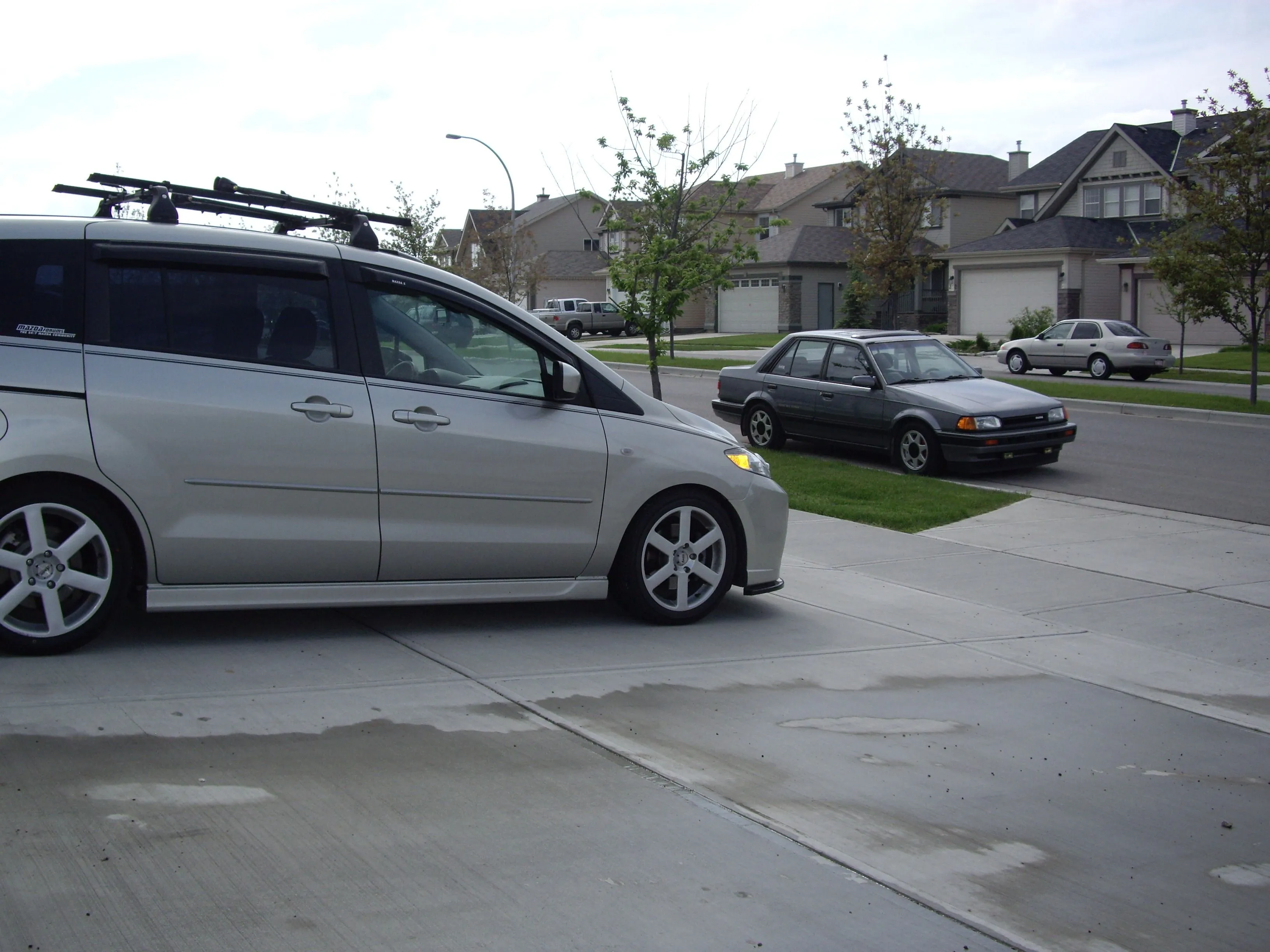

Lowered using H&R springs.....I cannot say whether these springs are made specifically for the '5' or whether these are the same as the '3'. I placed an order for Mazda 5 springs.

they are specific to the mazda5. h&r is the only company that makes mazda5 specific springs, although the 3 springs will technically work.
as will struts...as will swaybars...as will endlinks....as will headers...:)

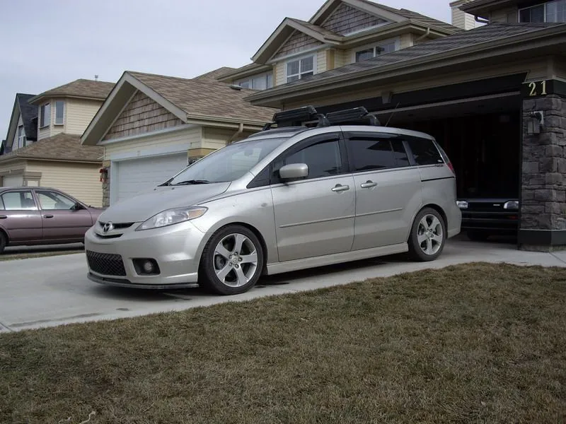

what's that black lip on the front of the 5? got more pics of it?

The lip on the '5' is a splitter I got from a buddy on the MPVCLUB forum.
It just screws into the existing bumper and is an easy install. His name is mazdaspeed02mpv...you can PM him on the forum to see if he has any in stock.

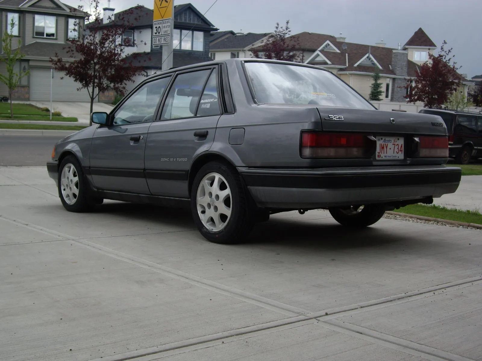

As for the Mazda 323 GT on the street...it's my baby...I actually use it more often than the Mazda5 these days, but will park it for the Winter.....I installed a set of 240SX wheels on it over the summer so it sits a bit better.

Here's another shot of the front splitter as requested...This is an older shot was taken last winter with the stock wheels and winter tires........I haven't taken any photos recently..
