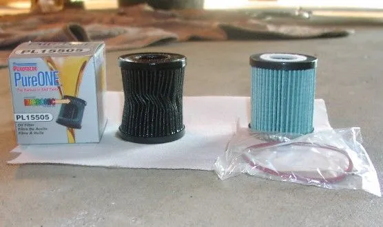

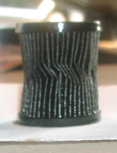

Changed to oil in the CX7 today at about 17,000 miles. I was using
Mobil 1 and the Pure One Purolator filter. I had not previously heard of the
issue with the aftermarket filters. The filter cap is spring loaded to keep the
filter under pressure on the base. Could it be that the filter medium needs to be reinforced to prevent crushing? Guess I better switch back to Factory Mazda unit.(uhm)

I wonder Zoom49, if it is only the filter height? Is it possible that the spring loading is forcefull enough to twist the filter as the cap is tightened? If this is the case then oiling the filter ends would lower the friction and allow the cap to tighten on the filter without twisting it. Zoom49: What are the filter photos? The used one is a PureOne but, what is the one with the blue media? Thanks Ed Hayes
Ed,
Both are Purolator filters, Used one as well as new filter are the same as part number shown on box. I will get dimensions using vaneer calipers to compare with your mesurements on the factory Mazda unit. Give me two days to post these.
