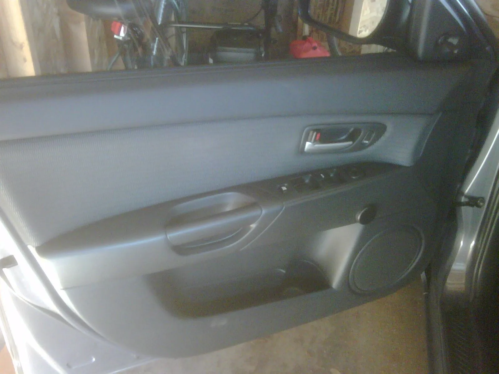

Once I had all the power window switches, door lock switch installed, my car now will lock and unlock by pushing the button. It will even detect when the door is open and wont lock the door if it is open! The parts place only sent me 1 trim screw (i have no idea why? i ordered 6 ) so i dont have all my switches installed tightly yet. and I still need to put the power window regulator and motor in once I have them. But it appears that everything is completely functional!!!!
Here is what I have so far... as soon as i get the power windows going, that manual handle will be gone!
