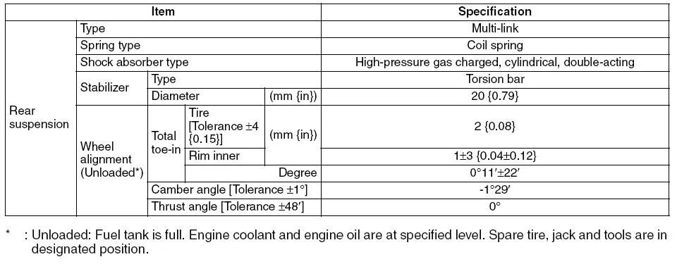

I went and paid for an alignment and they told me it was minor adjustments that they had to make. I think I will take some of the advice from 7red7 and see how it goes.

FWIW, negative camber is NOT the problem here. Toe is. The combination of extra negative camber and toe in is probably the issue for those with troubles. We don't have tire-wear troubles with ours except for having mild signs of too-high pressure (I keep them at ~38 psi).
I run negative camber on my cars up front on purpose, and have run up to 2 degrees of negative camber. The camber itself does NOT cause wear issues unless it's combined with toe.
Personally, I like to run the rears of my cars as close to zero camber and zero toe as I can get the shop to get them. HOWEVER, changing from these factory specs to a double-zero alignment may alter the response to turn-in and will almost certainly reduce grip in corners and emergency avoidance maneuvers, so that may not be a brilliant plan in this case. Personally, when we replace our tires or think we need an alignment, I'll probably have them zero the toe and leave the camber at or close to factory spec.

There is no camber adjustment on the 5.
Those excentric bolts only adjust the toe-in.
A very poor design
Excessive tire wear is usually a result of too much toe-in or toe-out. Anyone experiencing poor tire-wear, especially if one side of the tire is wearing faster than the other side, should have a GOOD alignment shop check their alignment. Negative camber, in small doses, should not have a drastic effect on tire wear. I would suggest shooting for an alignment of something like -1 degree camber front, -.5 degrees in the back, and 0 toe all around. It also helps to up the tire pressures by a bit. For street use a good starting point is usually somewhere around 8-10 psi below the tire's maximum pressure rating.

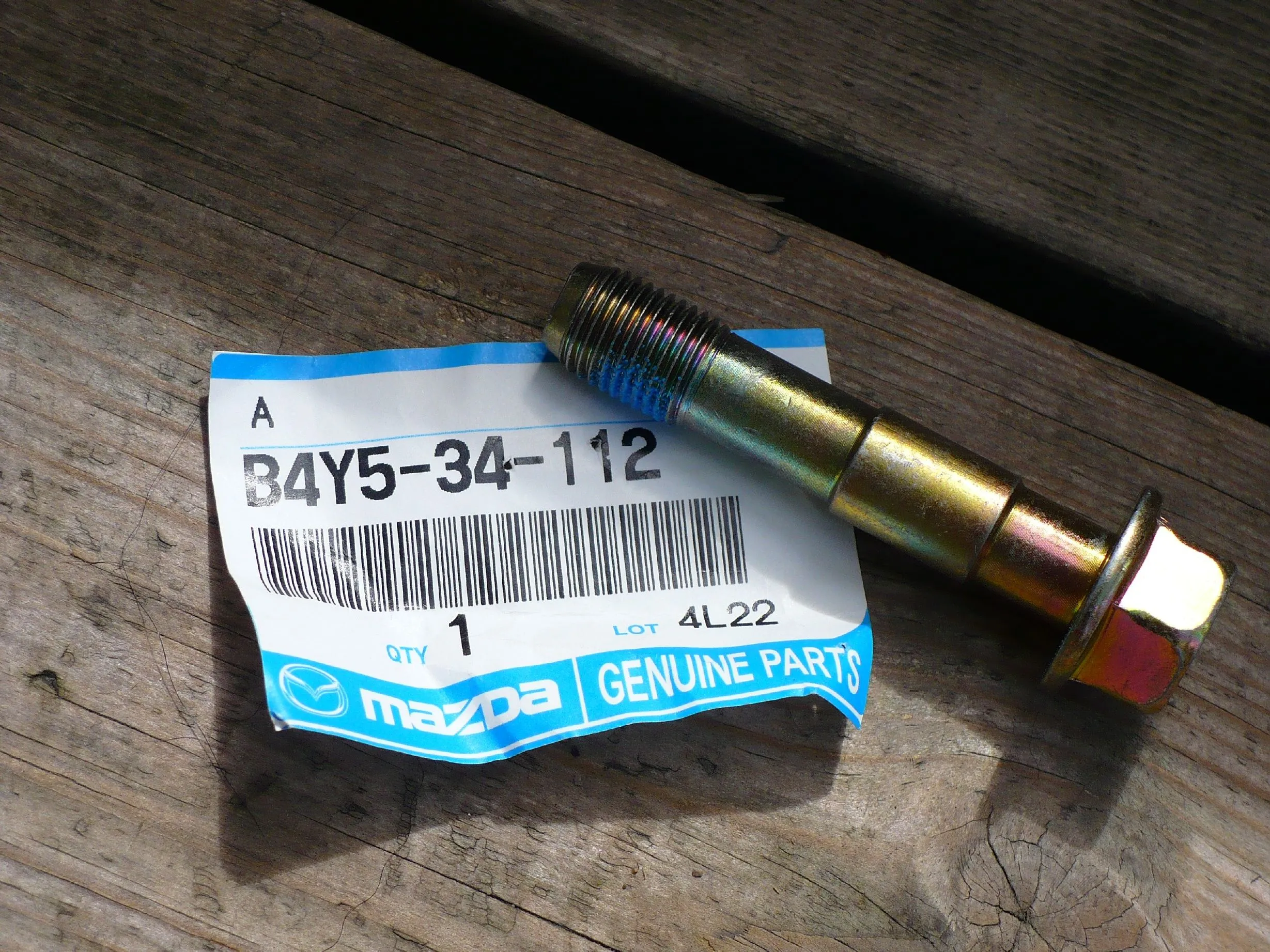

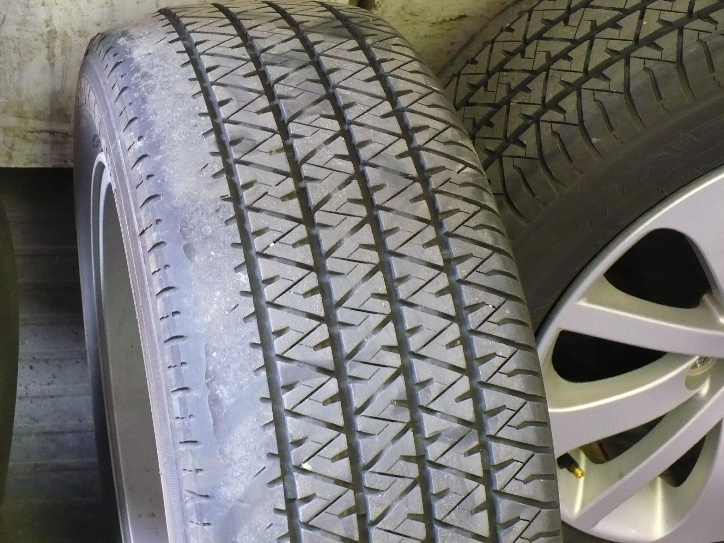

Well I can add to this forum. I did change mine over the winter and spring ( Toyos to snows etc) and thought that should be good.. well it wasnt. The Mazda dealer today gave me a fix and this will allow a little adjustment to the camber.It will allow a little more positive camber, by replacing the camber adj bolt with the bolt pictured.. I took the car to an alignment shop and they adjusted the camber AND toe..
Meanwhile I bought a decent used set of Yokohama Avid TRZ's.
I changed them spring and fall, between the Toyos and the winter tires.
That was at 16,000 km , and the time in between they were checked at the service interval. I had previous cars where I did the seasonal change and there were no wear issues. I did speak to Mazda Canada and they will be looking at it ( good luck). This spring when they were changed back , the garage I was at said the tires were bad , and that actually means the tires had 16,000 km.
on them
