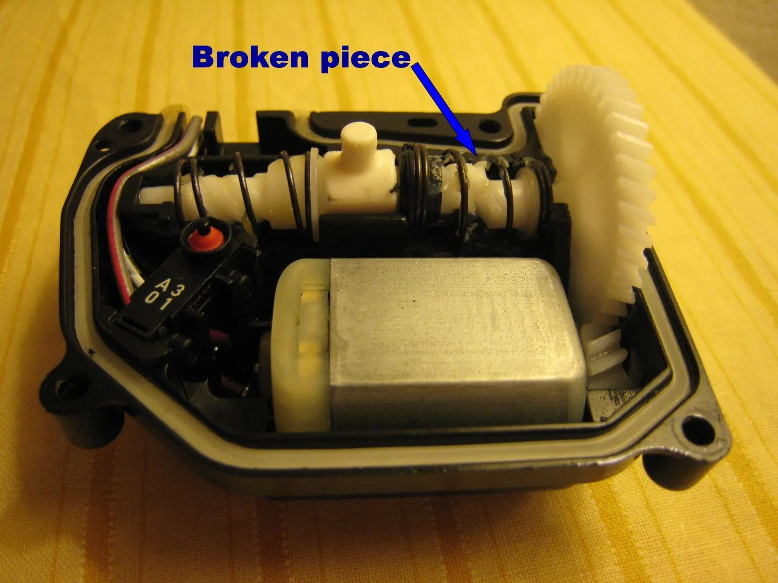

I had two go out, both driver side doors. In one the motor died, in the other the plastic gear snapped. So I took them apart and matched up the working parts so now the rear one works and the front doesnt at all. Oh well, not paying $100 for a new one.

its 100 for each lock motor/actuator. you could just go to the junk yard and pull one though, its pretty easy if you can find your generation car. Also, you might could piece together enough parts from the two to make one of them work. Thats what I did. The plastic gear was broken on one and it made a sound like it was trying to work, clicking a whole lot. The other just did nothing because the motor was dead. So I combinded the good motor with the good gear and made the back door work. My driver door does not work, but I open that with a key anyways so it doesnt really matter.

Mine still make noise, so from your description, maybe the gears went bad. Your junkyard idea is a good one! Thanks man.

Here is a pic of the plastic piece that is probably broken. It is what broke on me, and on another member who posted in the below thread. If you can find this at a junk yard, you just replace the plastic gear and you are good as new.
http://www.mazdas247.com/forum/showthread.php?t=123661122&highlight=lock+actuator
