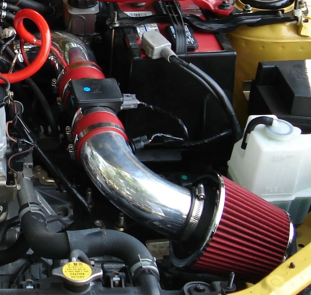

i'll do a how-to on this once i can get my MAF cleaner. :) what has to be done to clean the IAT? it's not sensitive like the MAF is it? i dont wanna damage the MAF so do i just spray it and around it?
attached pic of my intake. IAT is the sensor b4 the MAF correct?
yup that's the IAT. I guess if there's oil on it just wipe it off. It isn't sensitive.. like you can touch it and stuff. mine is cracked though (from the accident.. and the fact that it isn't installed in my intake at all, it's just hanging free in the engine bay) so I guess it's still a little fragile, but the MAF is just in a whole nother league of fragility.
