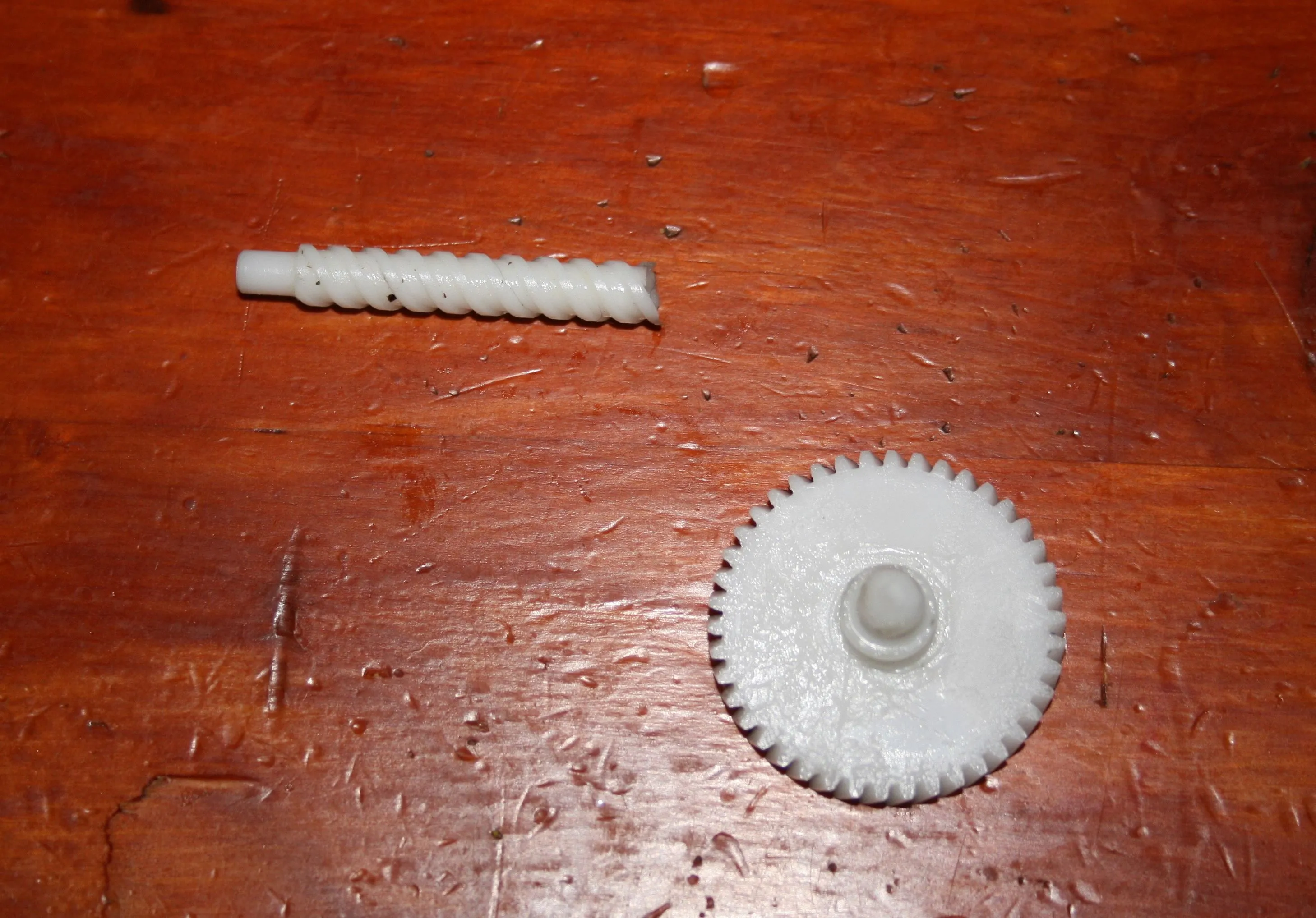

I've also got some things I need to fix. The sub has stopped working, I need to pull it out and see if its blown or if the wires are loose. It hits every once in awhile, so I'm not sure. Also, my passenger rear door lock is not working. Whenever I hit the lock/unlock in the car or on the remote, it makes a funny whirring noise. Didn't find anything like that in a search except for one other person, but no responses to his thread from over a month ago.

First off all IF its a stock battery, they sucked from the beginging. The other buzzing noise sounds like the actuator for the door lock (motor) is binding, try removing the door panel and see if anything is binding it or maybe the motor has worn out. But have to at least see if it's the cheaper one. Good luck and congratulations on your purchase.

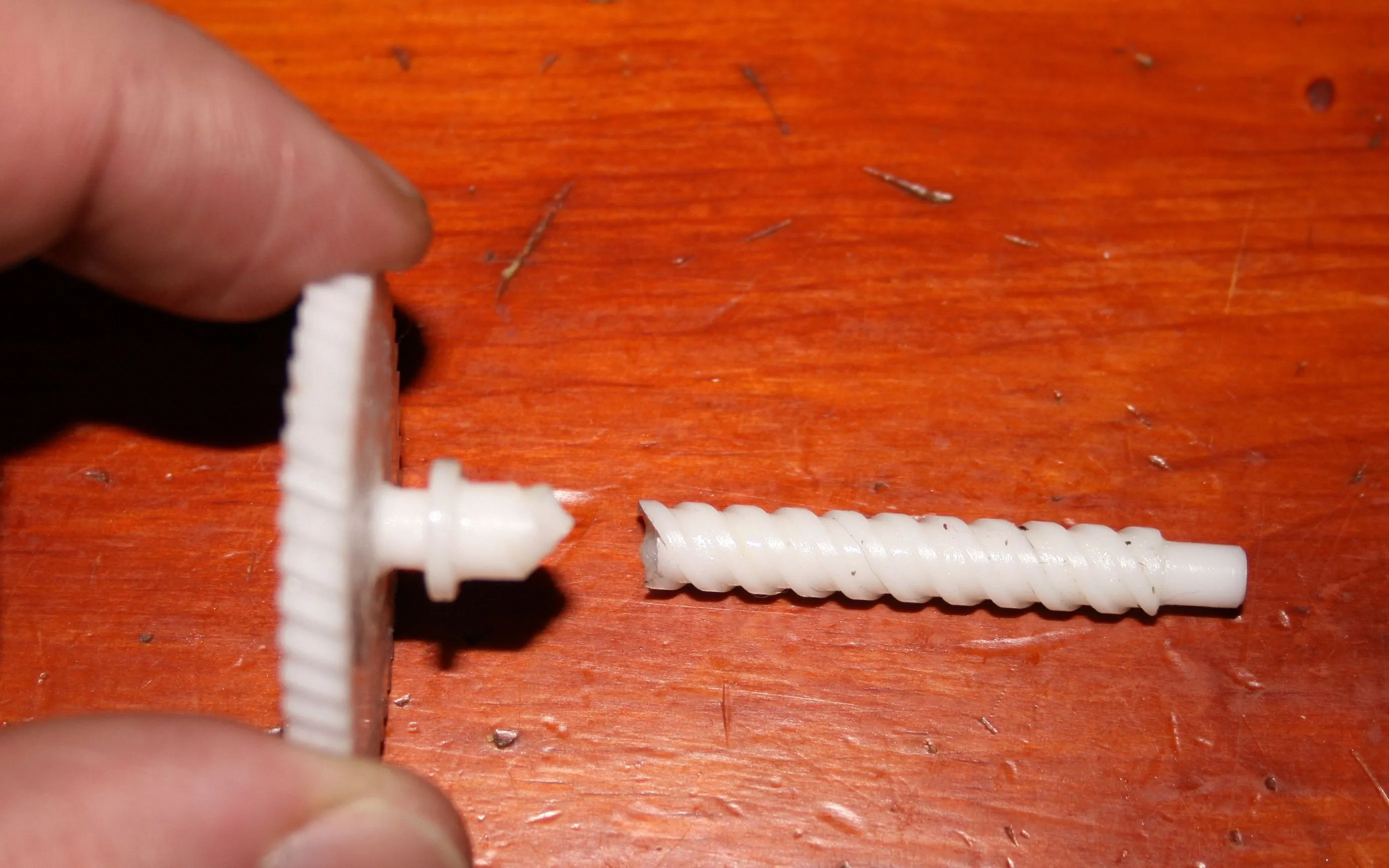

Well, I found out the problem with the door lock. The little gear thing in the actuator is broken. Same as in this thread:
http://www.mazdas247.com/forum/showthread.php?t=123661122&highlight=lock+actuator
I'll snap a closer pic of the broken piece, I'm just curious if it possible to find the same piece somewhere rather than replacing the whole actuator. The long part of it is threaded like a screw and it has the big gear on the end. Anyone seen these type of things for sale anywhere?

Digging up my old post, I've attached the pictures as promised.
