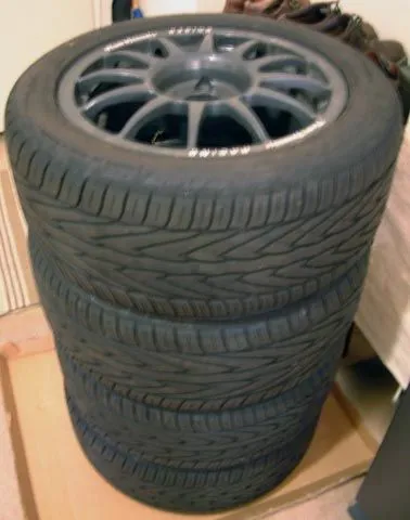

picked up some of these:
nice, now get some decent rubber for those ;)

lol ok ok. I meant a couple notches higher... like some azenis, hankooks or Bridgestones ;)
