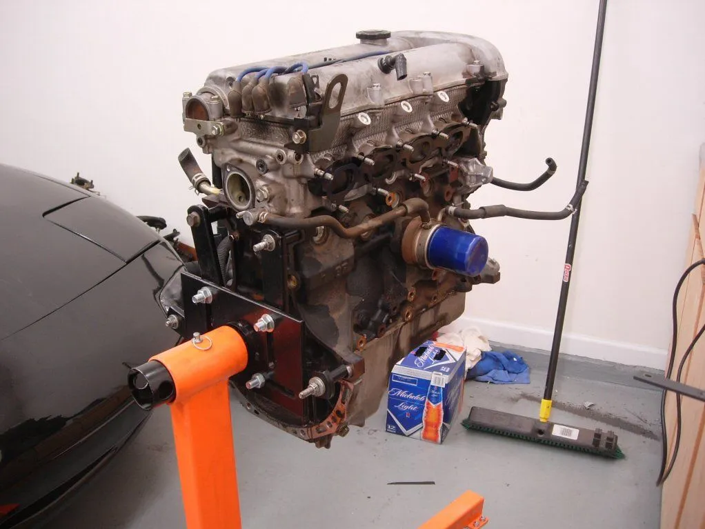

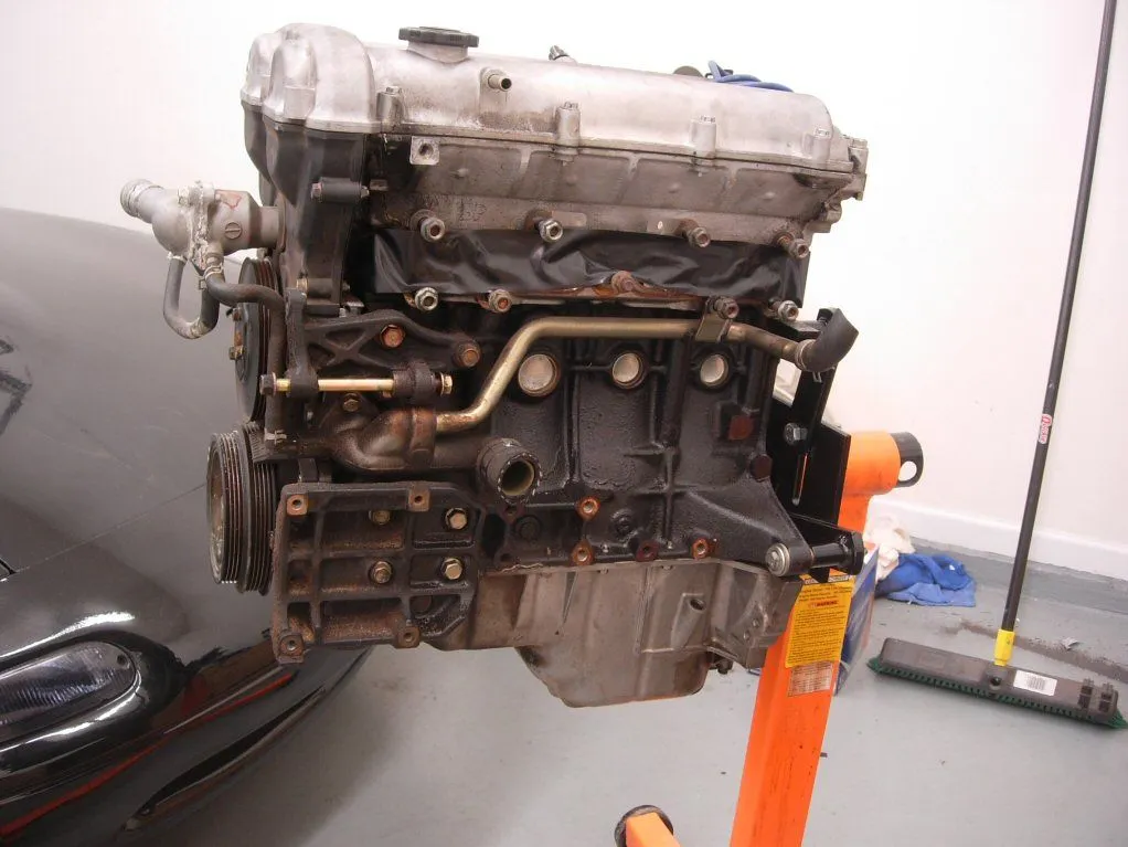

Inward steps the 1999 1.8L that I picked up today for $400 (120k miles with a new water pump, timing belt, etc). A hell of a deal if you ask me. Furthermore, a perfect catalytic converter was included for an extra $20 (stupid emissions). I've been urning to install one of these engines into the car for a couple of years. Furthermore, I have another '99 engine in the basement that awaits a rebuild (to tolerance and spec), but I haven't had the time to undertake that process. So when I came across this deal, I jumped on it. This engine will tide me over until I can fully rebuild the "spare" engine that currently remains parked downstairs.
As usual, business has me traveling for the next few weeks with an auto-x or two in between, so it'll be mid-April before this is installed. As with my previous build threads, I'll be posting plenty of pictures for those that are interested. :)
Without further ado, so begins the engine swap process :D

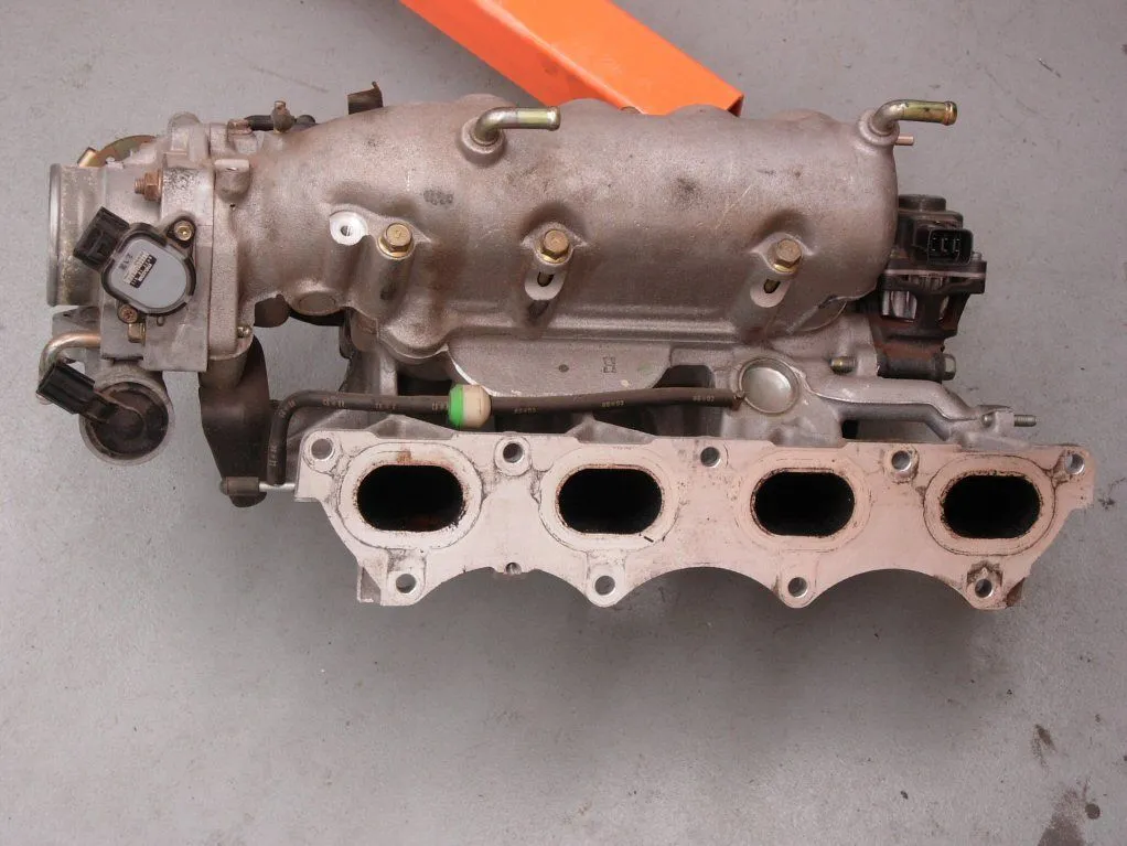

The '99 1.8L uses a return-less fuel rail. A return type fuel rail from an earlier 1.8L will not work as the ports for the injectors do not align properly. However, one can use the '99 fuel rail with the 1.6L fuel pressure regulator. Unfortunately, the return line will have to be routed above the manifold due to the positioning of the regulator. However, this will not cause any problems.
Original configuration of the '99 fuel rail without return:
Comparison of the '99 FPR and the '1.6 FPR:
The 1.6L FPR installed on the '99 1.8L fuel rail:
The fuel rail, intake manifold, and alternator bracket (in that order) will be installed after the engine is placed into the car (for ease of engine installation).
