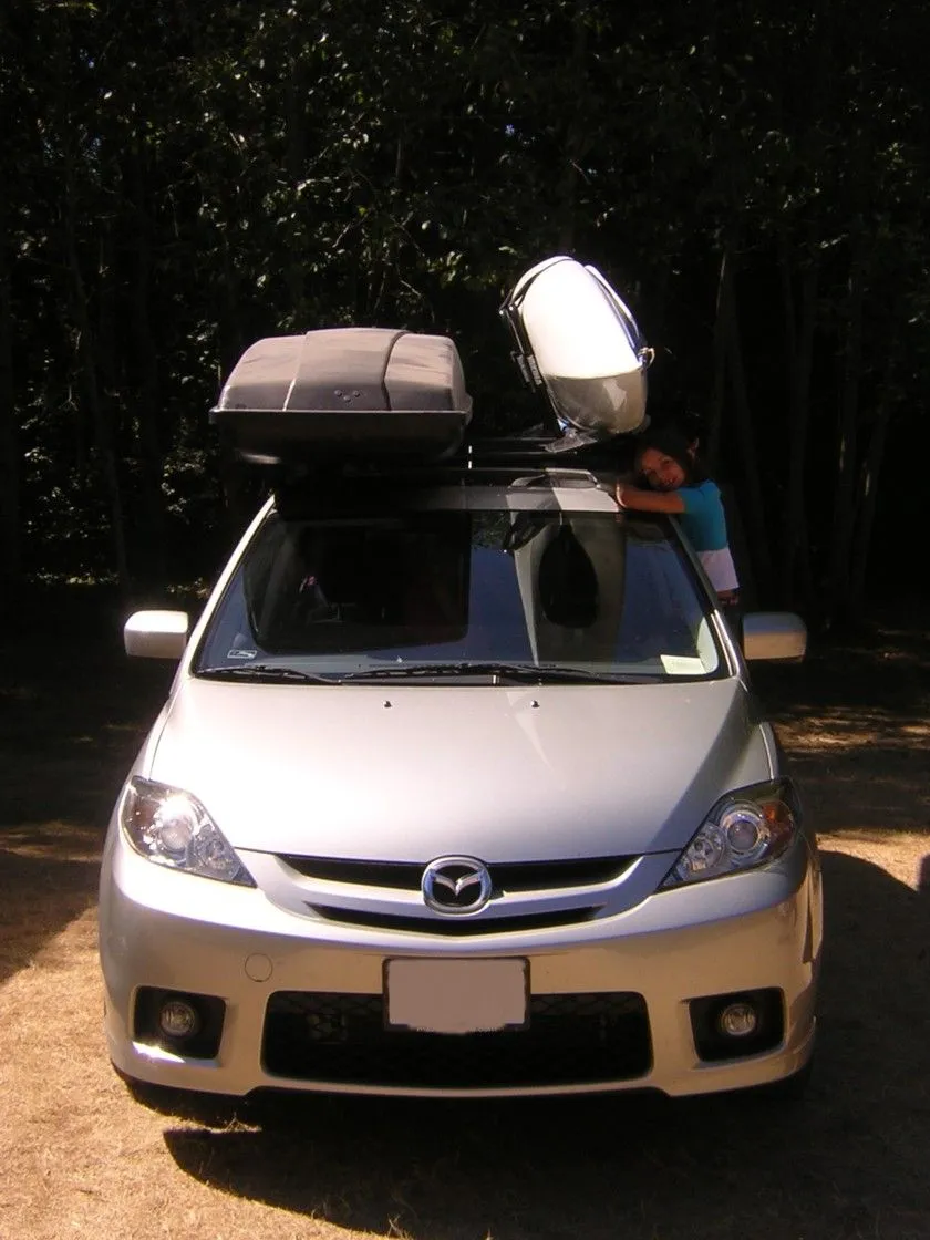

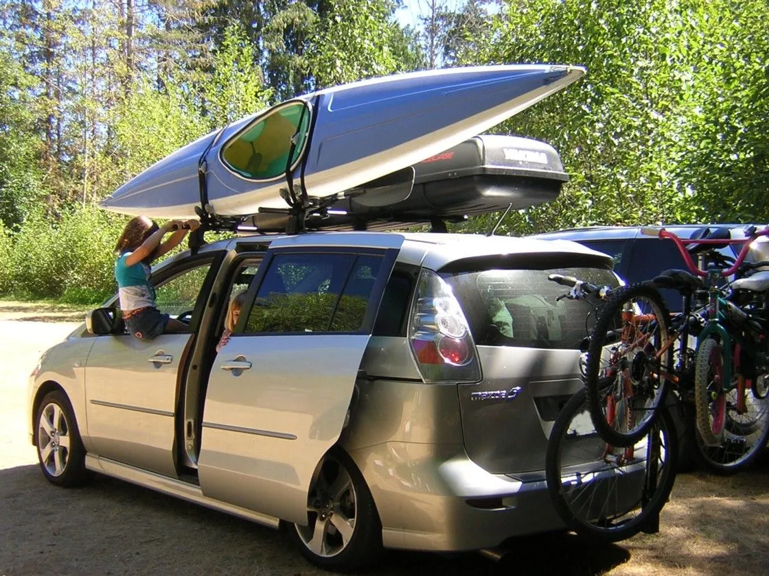

I recently purchased the Yakima racks for my 2007 Mazda 5 and they are terrible. I have 2 problems with them. The first problem is that the sliding doors hit the qclips. I've been trying every adjustment I can think of and there's no way around it?!? Also, the front bar is a few inches lower than the back with makes it look ridiculous! The reason they are lower is because Qtowers on the front are spread apart more than the ones on the back.
Sounds like you need to adjust the space between the rear towers. I had a similar problem but once I got the spacing perfect - the doors close within a hair of the clips. It's a frustrating adjustment because things shift slightly on the towers when you go to tighten it down, but keep at it because it does work.
As for the height difference - I agree - it doesn't look the greatest but bottom line is that I can carry Yakima's largest box and a kayak. I'm likely over the weight limit but so far no problems.

For me it was the fact that I already had all the Yakima components and only needed the adapter clips. The bonus is that I can have longer bars which accommodate a kayak/bike and the cargo box.
I wouldn't be able to put my cargo box plus one other item on the Mazda rack.
Here's a front view photo to show the space.
