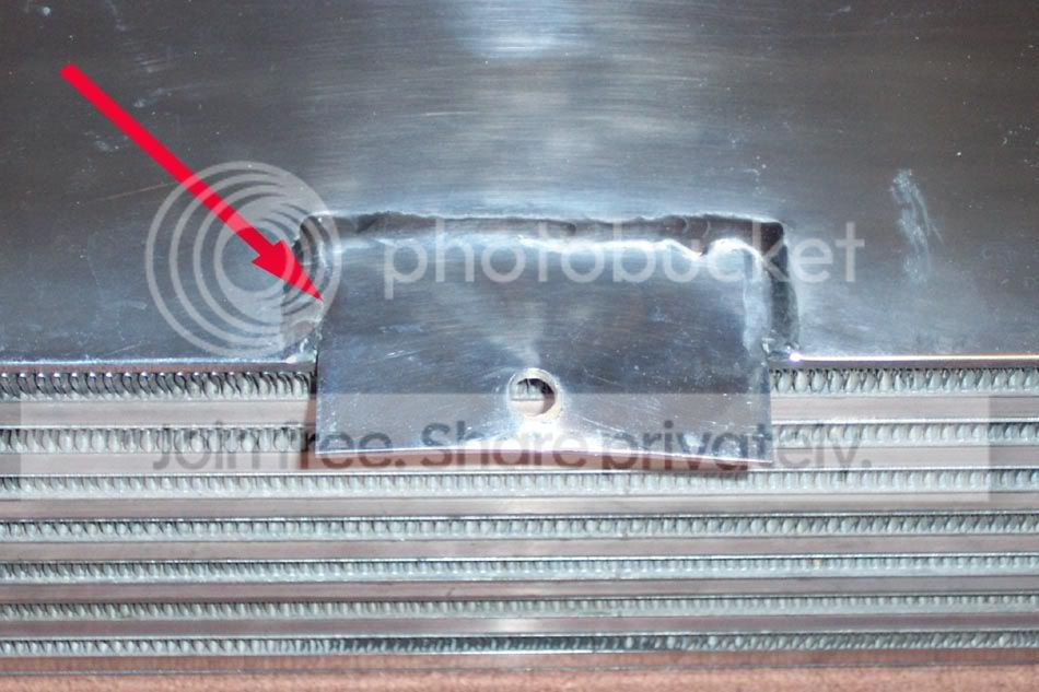

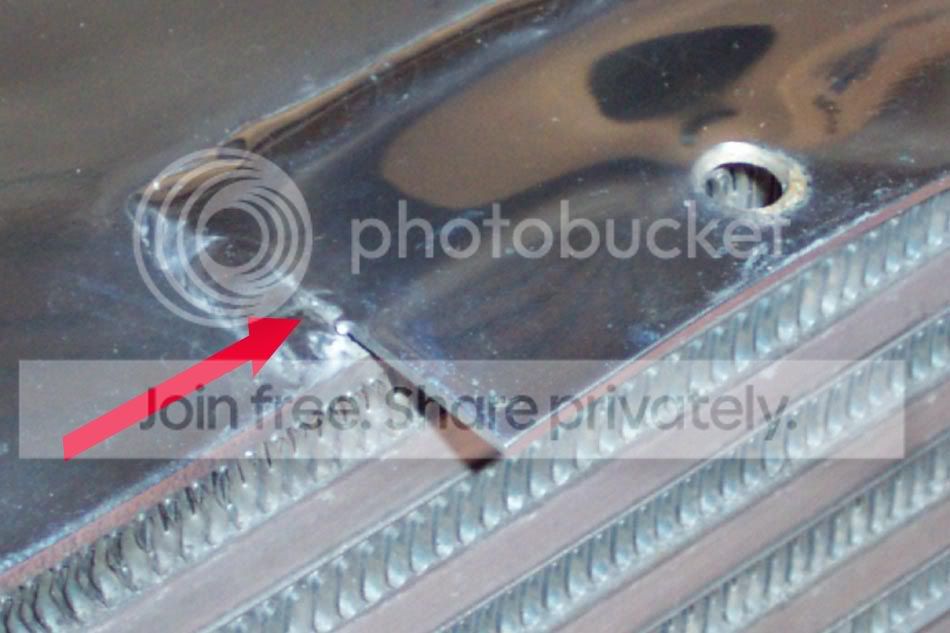

    I have a concern with the mounting tab on the FMIC. The weld is starting to crack on one side of the tab and I am afraid that it will eventually fail completely. Is there any reason why there weren't two (or more) tabs added to the unit, say one at each end, for a more secure fitment? I was thinking of doing this for my install.

    It looks like the weld's bead didn't really grab the bracket much. Take it to a local welder and they can lay a few beads down for a couple of bucks.

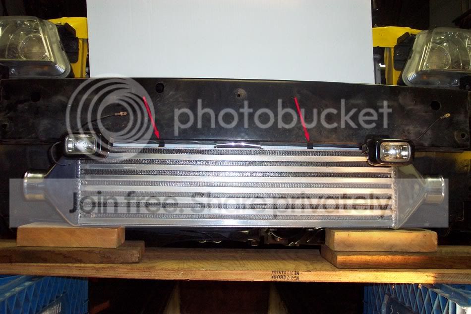

    So I'm looking at installing my FMIC and I come across these 2 plastic pieces attached to the back of the bumper that have a small tab that extends down below the bottom surface of the bumper. They interfere with mounting the core flush against the underside of the bumper. There has been no mention of cutting these off in any of the "How-To's" that I have seen for the FMIC install.
    So what's the deal with these? I couldn't see any obvious need for them so... ?
    (P.S. I put a sheet of white plastic in behind so it would be easier to see what I'm talking about)

    break out some snips and have at them.
    you definitely want the FMIC flush with the steel bumper

    Yeah, remove those. I did...

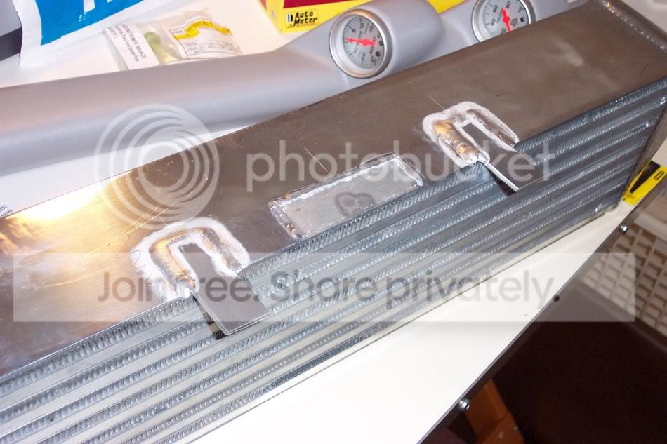

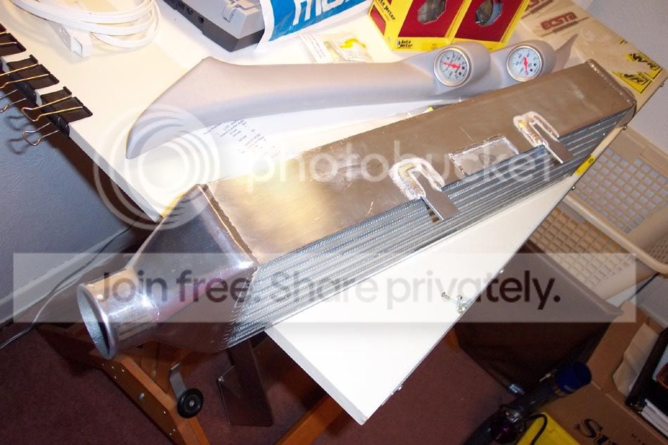

    On another note, here's how I addressed the cracked mounting tab issue on the FMIC. I still have to grind off some more of the old weld.
    I'll feel a lot more secure with the additional support.
