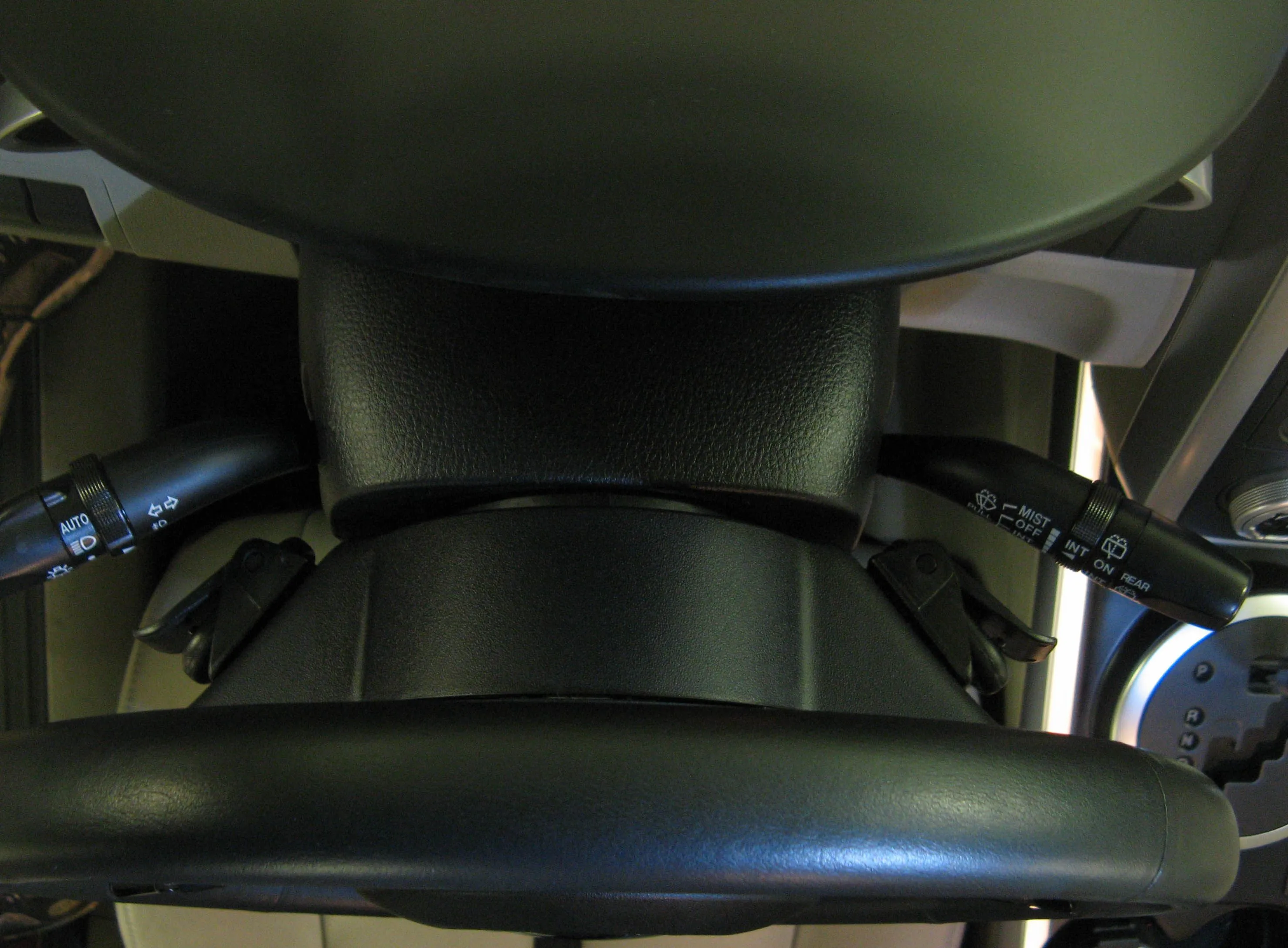

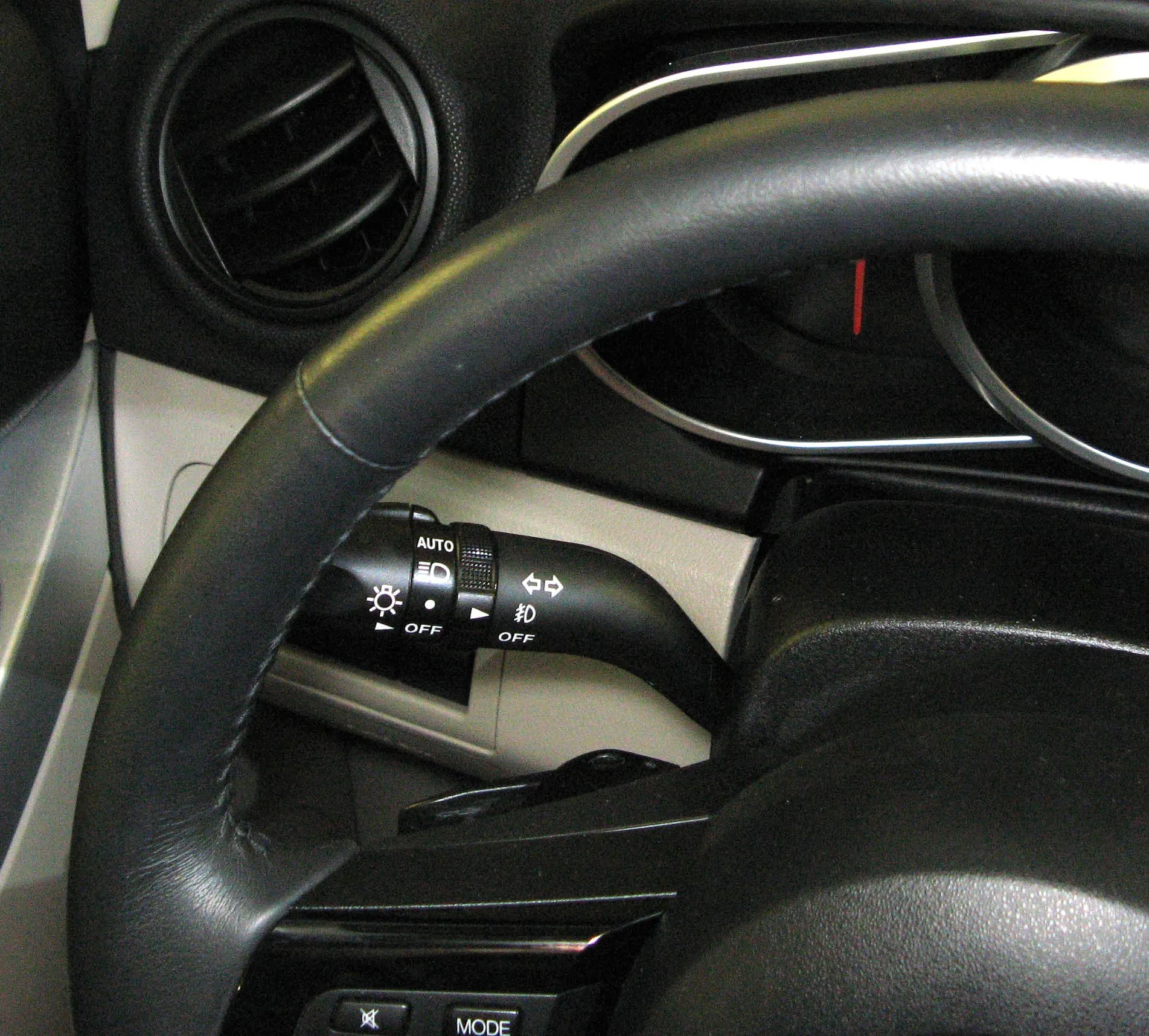

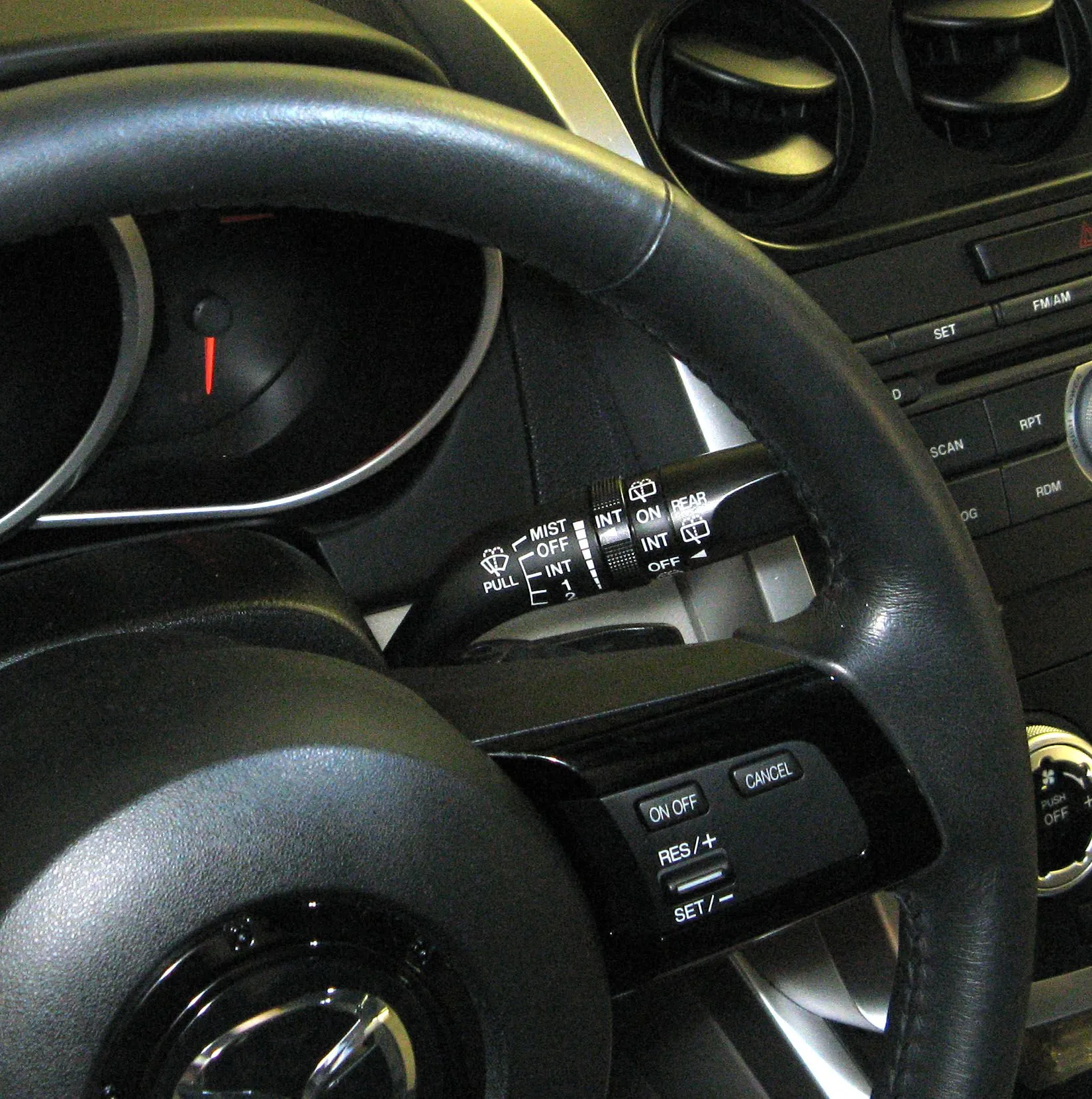

I made an effort to add shift paddles to my AWD-GT using two RF remotes, one for each side of the steering wheel. I decided to make the right upshift, and the left downshift as this seems fairly standard across other cars.

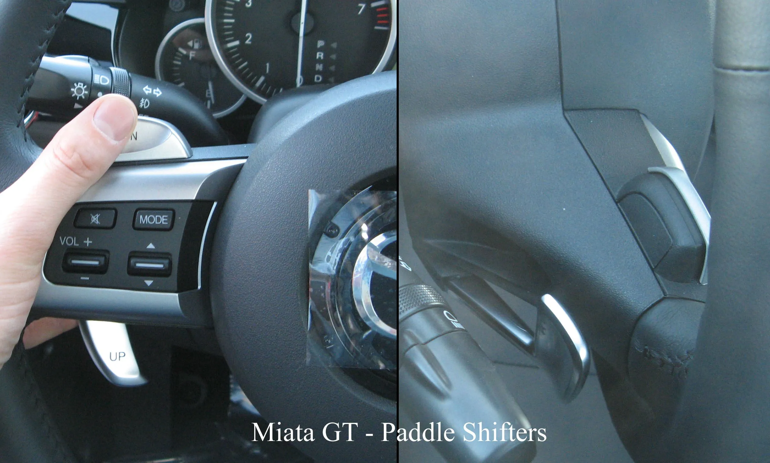

My first idea was to borrow the shift paddles from the Miata GT, but this would require changing the steering wheel, or perhaps cutting a mounting location into the CX-7's wheel. The Miata's paddles upshift with the "UP" paddle, and downshift with the "DOWN" button, the same on the left and right sides. They were asking $140 for each paddle. It seemed better to make my own for the CX-7.

I made my paddles wireless, to avoid the need to wire through the steering wheel. They're attached to the back of the steering wheel by a bracket fastened with the airbag mounting bolts (under the rubber plug)

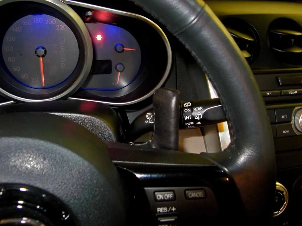

I changed the positioning of the levers to make it a bit easier to press and because my fingers kept getting caught in the turn signal.
Now the levers are vertical and closer in to the steering wheel.

Wireless? How quick are the shifts though? Stock "manual" shifting is isn't that quick to begin with.
Same as for the shift lever.
Well, perhaps 0.25 seconds quicker... or however long it takes to move the right hand from the steering wheel to the shift lever
Rapid shifts are a bit faster, at least only because you can trigger click a bit quicker than moving the shift lever.
