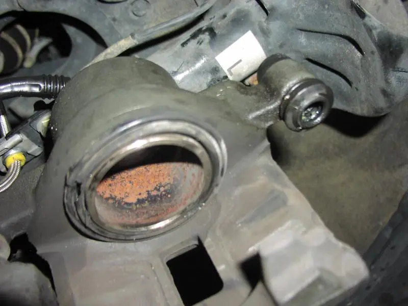

HELP!!! I finally finished a brake upgrade to powerslot rotors, hawk hp pads, corksport SS brake lines and new fluid. Put everything back together, take it for a ride aaaand there's a slight oscillating sound from the left front. Take it apart, check, everything looks okay, put it back together, take it for another ride. Oscillating gets WORSE. Take it apart --- it seems the caliper is rubbing the edge of the rotor!?!?!?!?!?!?!?!?!?!?! There are rotor shavings inside my wheel well, and if I move the caliper-part that holds the brake pads up out of the way, the wheel moves smoothly, but if I put it down and bolt it together, the rotor rubs the caliper!! Here's a picture showing the inside of the caliper where the two edges of the rotor have worn away part of the caliper (not much, but the shiny parts are where it's rubbing, the filthy parts are where it's not rubbing). HOW CAN I ADJUST THE CALIPER?!?! Did powerslot send me a defective rotor?!?!?! ANY IDEAS??!! AM I ******?!?!? My car's been down for TWO WEEKS I'm gonna lose it if it's going to be down for another, or if I have to put my tiny highly warped stock rotors back on. ANY IDEAS?!?!?!?!?! HELP!!
The right front is FINE it's only the left front! It seems like the rotor is 0.5 or maybe 1.0 millimeter too large in diameter, but since my right front is okay I'm thinking my caliper is warped slightly. Can hard braking do that???? Was my car born deformed?? :( Any ideas on what I can do other than tow it to Mazda or burn the ******* thing and get a subaru??? Okay enough venting but I'm really pissed................

So I took it apart and put it together and did another road test and still that loud oscillating sound. It sounds as if my brand new rotor is extremely warped. So I took it apart, took the rotor off, and I can't see anything. The hub looks fine, I sanded-off the rust from the outside so the rotor should sit nice and flush, just like I did all the other hubs, there's no excessive wear on one part of the rotor as far as I can tell. Any clues as to what I can do tonight? I'm supposedly going to Mazda's rev it up! tomorrow but sadly I may spend the day at Mazda which would be quite upsetting. >;( If anyone has any ideas I'd appreciate anything at this point.........
Hmm, maybe you got a MSP rotor by accident? Try checking the caliper mount bolts, the bolts the hold the mount to the hub....might be able to get adjustment from that. Or you might just have a defective rotor...
Got pics of the rotor? That dust cover is torn up pretty bad too....

Well the good news(?) is that _I_ was the defect, not the parts. I installed the inside pad on the outside and vice versa, so the wear indicator was gouging the rotor. Luckily it didn't gouge it much, but enough to make the grinding sound. I don't know why it oscillated, but Mazda pointed this out, fixed it, and it's been working great ever since. My pads came with what looked like two wear indicators, a long one and short, and I didn't know you were supposed to cut off the long one. Anyway, I'm an idiot, nothing new there. I sure wish the pads came with insutructions though. Last time I make that frustrating mistake!
